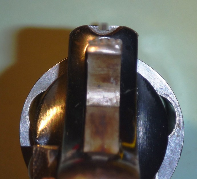

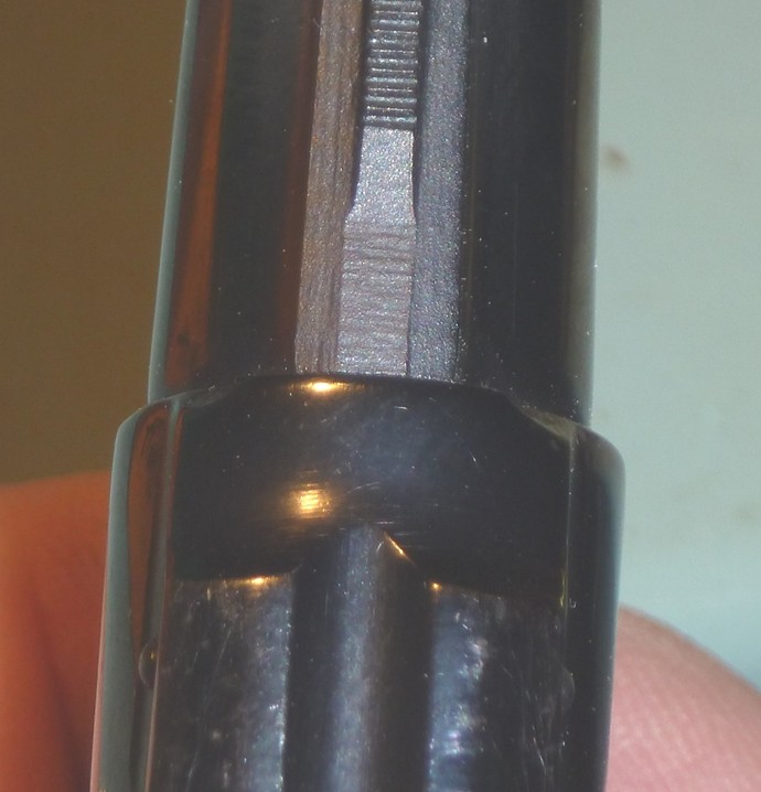

When barrels are turned into revolver frames at the factory, the assemblers are more concerned that they don't come loose, therefore it is common that barrels may be over-tightened, sometimes causing “thread choke” or collapsing of the bore adjacent the root of the barrel thread, or “off-shooters” in which a barrel snugged too much shoots to the right, as its front sight can be seen to lean very slightly towards 1130, rather than being absolutely vertical.

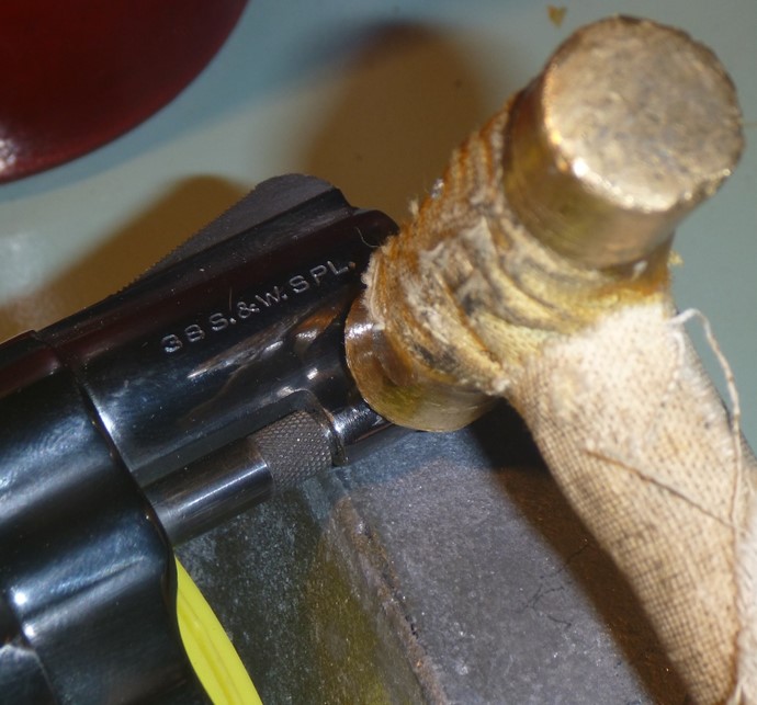

A recent purchase of mine, an S&W Model 36 (no dash) of 1960s manufacture shot about 4” right at 7 yards with factory wadcutters.  If I just point-shot the gun at 50 feet, ignoring the sights, but using only the weapon silhouette point method, I could keep them all in the K5.  But I would like to be able to head shoot a rabbit or grouse if an opportunity presented itself, so the sights needed to be closer!
This revolver was a “pinned” barrel model.  I didn't wish to remove the barrel pin and chance loosening the barrel and maybe having to take it to a gunsmith to have properly reset.  SO I relied on my Ruger training and experience to WHACK~! the barrel just enough to back it off solidly against the barrel pin, hoping that the slight rotation possible would position the front sight closer to 12:00 dead-center and and point of impact would be  "close enough” for my intended concealed carry and woods walking use.
I used a small 4 oz. brass hammer from Brownell's, resting the revolver barrel on a lead block, and decided that several well-calibrated, carefully executed smaller whacks with my small hammer were safer than attempting one mighty blow with a BFH, given the small target afforded by the Model 36's tiny barrel lug.  After about six careful blows my eyeball inspection indicated the front sight was now almost perfectly vertical, and that the cylinder opened and closed easily and the center pin locked up as it should.
A quick trip to the range revealed that point of impact was now close enough.  I just saved myself a 60-mile drive to Northern Virginia Gunworks and a minimum gunsmith labor charge.

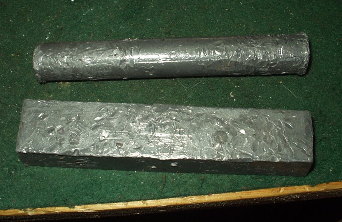

Great explanation! I was trained in the same manner at S&W, but using a lead babbit. Don't be afraid to try this, you won't mar the finish and it the “rap” will only move it a little at a time. Below, two of the most useful tools on my bench.
