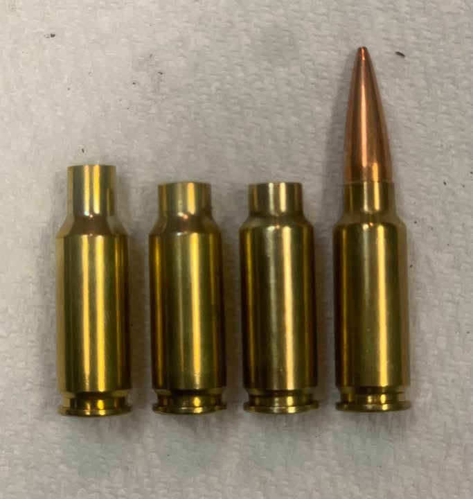

Bill the cartridge is the .30 Whitetail which from what I've read is an 1.400 long case with a 40 degree shoulder formed from 6 BR cases. To comply with these stupid hunting regulations we have in Illinois I think a bottle necked case has to be no longer than 1.400 in. Maybe the same applies to straight cases but I don't know.He doesn't shoot cast bullets but according to him 5744 works very well in the gun.

Pat, any chance you have access to both a .30 Whitetail and a .30BR case? I believe the .30BR case has a case capacity of 41 grains of water. Thanks, Bill C.

Now I will say this, by the picture I’ve seen of the “30 whitetail”, if they’ve pushed the shoulder back to maintain neck length, (30 Bellm has a short neck from blowing out the shoulder to 40* and trimming the neck back to 1.4&rdquo
then the 30 Whitetail will have less case capacity than the 30 Bellm, which was the whole point, 110’s at close to 2700 fps.
Tomorrow I’ll dig out a couple of cases and take pics,,,,
