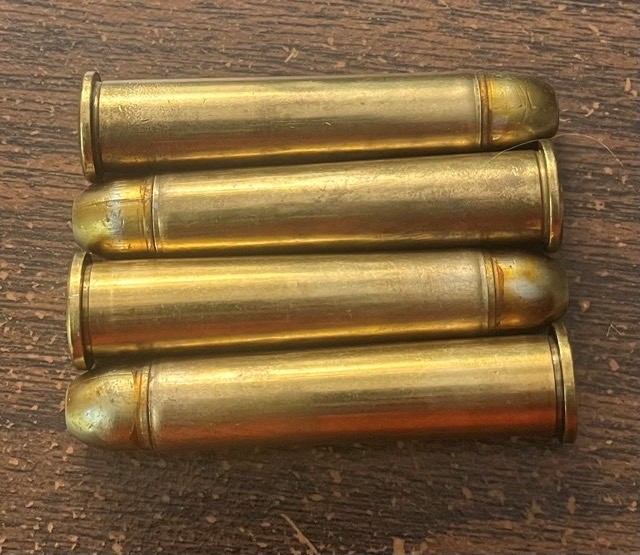

Nice golden sheen on the bullets....

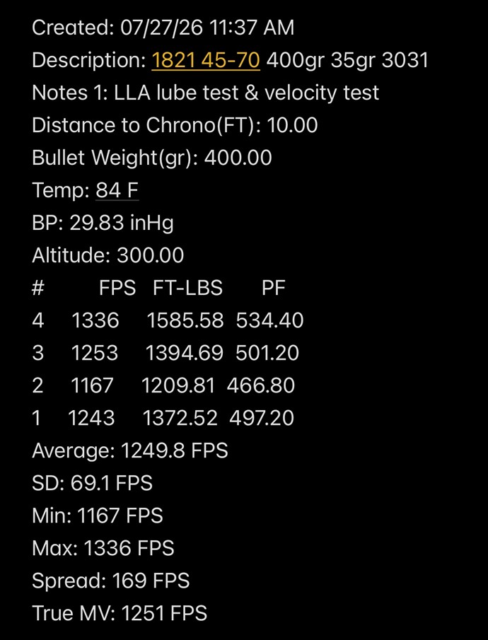

The chrono data....

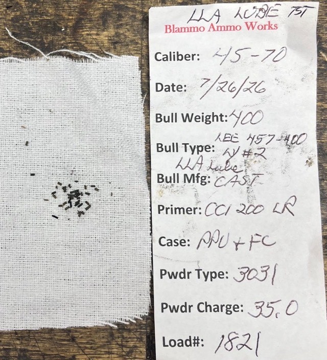

The powder residue....
Nice load....easy on the shoulder....The LLA worked. Granted it's only four shots but the stuff actually worked.
