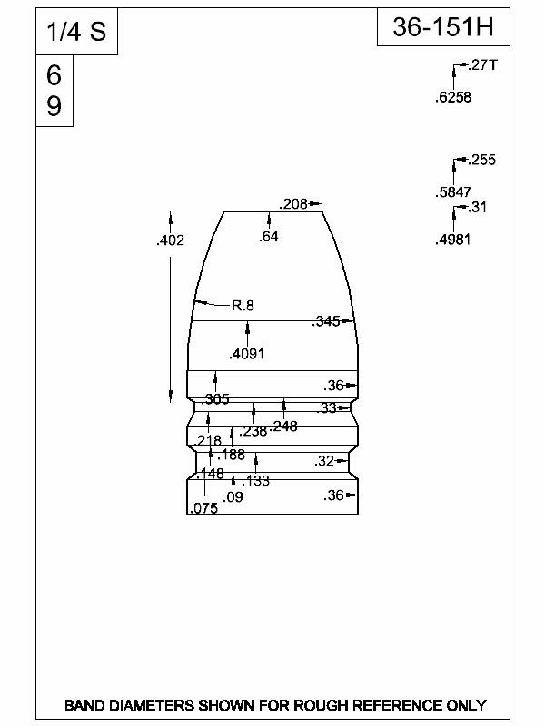

As FYI, now in the Accurate catalog 36-151H is based on the 45-240H1 for the .455 Webley, simply reducing the diameter to .360” with tolerance positive to provide correct fit for .362” cylinder throats as-cast without sizing.

The Accurate 36-151H mold blocks arrived today, tomorrow I plan to cast bullets for you, Ric Bowman and Joe Gifford to test and get them all in the mail by the end of the week.

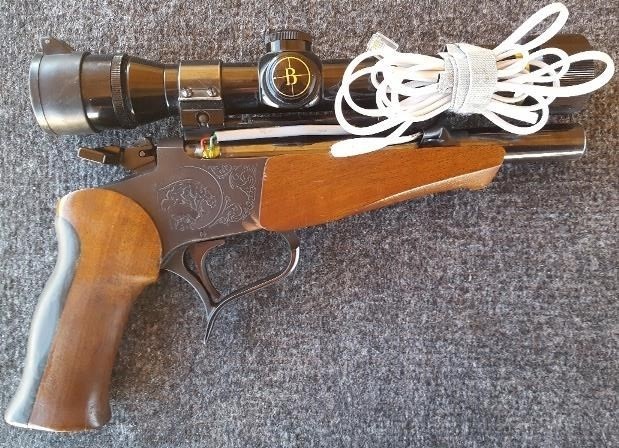

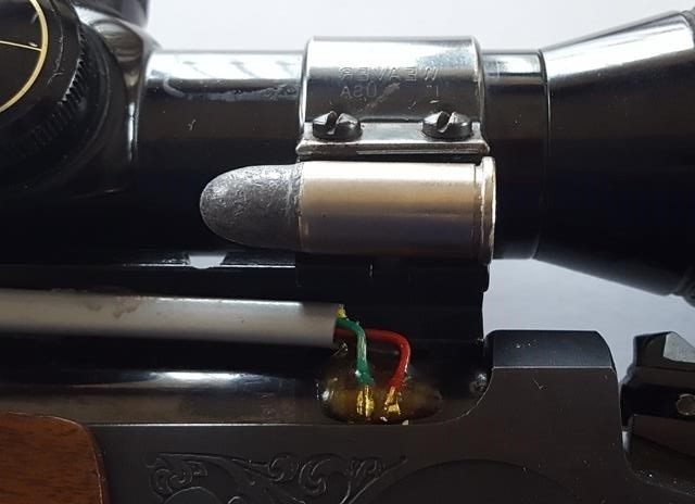

The test handgun is a TC Contender with a 7.94” long 357 magnum barrel. The bore is .347 and the groove is .357.  A strain gauge is attached over the center of the chamber (as per SAAMI specifications).  With a 38 S&W cartridge chambered the gauge is over the case just below the base of a factory seated bullet.   The strain gauge is attached to an Oehler M43 PBL that is interfaced with a laptop computer which has the software.  As you will note on the Oehler data sheets there is considerable data input on the conditions, test firearm and load information prior to testing.  Each strain gauge is calibrated by the manufacturer and that is also input.  I also use factory ammunition as a “reference”.  Before each test the M43 runs a check on the gauge to ensure all is correct.  A test cannot be done if that test is not correct.
