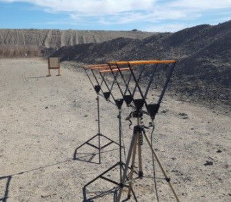

 The Contender has a 2.5X scope mounted and with quality 357 cast loads will put 10 shots into one raged hole less than 1” ctc at 25 yards. However, with the shorter 38 S&W cartridge the bullet exits the case it is not supported as it is in a revolver by the cylinder throats before entering the barrel.  In the Contender chamber there would be considerable space around the bullet in the longer chamber for probable misalignment before the bullet enters the leade.  Previous testing showed accuracy could be quite good and very poor.  Since I’m probably the only one shooting any 38 S&W out of a Contender that isn’t a problem those of you with bullets that properly fit your revolvers cylinder throats have. The test groups were cut out and pasted to the Oehler data sheets.
With low pressure loads the M43 PBL will not provide any measurements unless sufficient data is measured.  This means any data from such shots will be “lost” including the velocity.  To alleviate that problem I also set up a M35P Oehler in tandem with the M43 PBL screens to at least capture the velocity.  It also is interesting to compare the measured velocity data.  If the M43 PBL doesn’t measure all the shots in a test string the M35P still provides velocity information (generally a lower velocity shot wasn’t measured) for study.  An example of that will be shown.  The M35P print out is pasted on the Oehler M43 data sheet left of the “shot Data” and “Summary” data.
 The start screen for the M43 PBL was at 15’ and at 12.5’ for the M35P.  Shooting was done from the bench with a Hoppe’s pistol rest.
