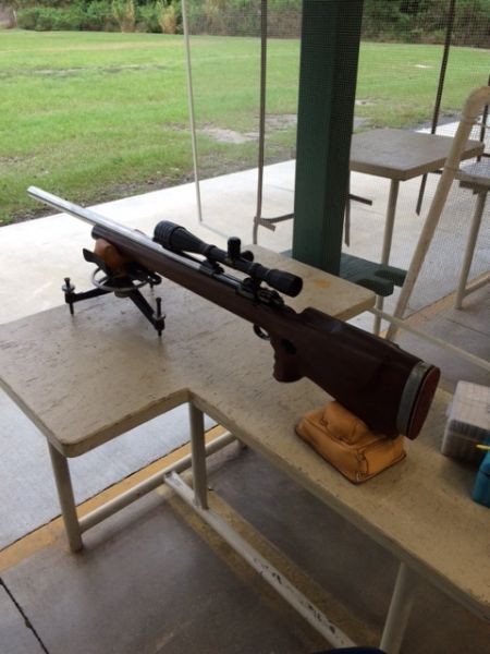

Joe,there's no reason for alarm. Yes, last night my rifle shot a 5-shot group at Markham Park that measured .9 inches. Avg. MV 2851 fps, ES 45, SD 18.3. Cartridge was 30XCB wildcat (30x57), bullet was NOE 310-165-FN (xcb). Charge was 56 grains RL-22, case filled to overflow and sealed with a lube cookie. Alloy was Linotype, lube:Lars White Label 2700+. Bullet sized to .310, Hornady gas check. Breech seated with Tim Malcolm's breech seater. I prefer 10-shot groups, but only had 5 of these cases preloaded. Pat Iffland can be assured that witnesses were present. Also shot last night: 10 shots, 100 yards, same combo as above but fixed ammo: 45 grains Winchester 760. Group size 1.60", avg. MV 2658 fps 10 shots, 100 yards, 43 grains LeveRevolution, group size 2.1", avg. MV 2846 fps The rifle is an old target gun (mid-50s, I have seen a picture of Gene Beecher holding an identical rifle). Big thumbhole stock, FN commercial BLIND SS action, new Shilen Match SS barrel, 30.5 inches, 1:14 twist. I purchased the rifle as an old-fashioned “long range” rifle chambered in 30-338 Win Mag, with a shot out barrel. An “accident” that involved shooting a cleaning rod 50 yards at 1800 fps (chronographed) sealed the barrel's fate and it was re-barreled to its current condition.

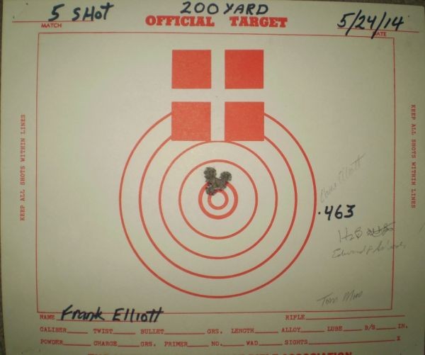

Slow'm down to around 1500 and on occasion, you can get groups of five, shot in a match and and sign by the witnesses like this at 200 yards. Not a record, it's about .1” off it. Frank

Great group Frank.

That's pretty darn good Frank, but I'll let you rule in that end of the specter, I'm starting to like them hot....:hunt:
