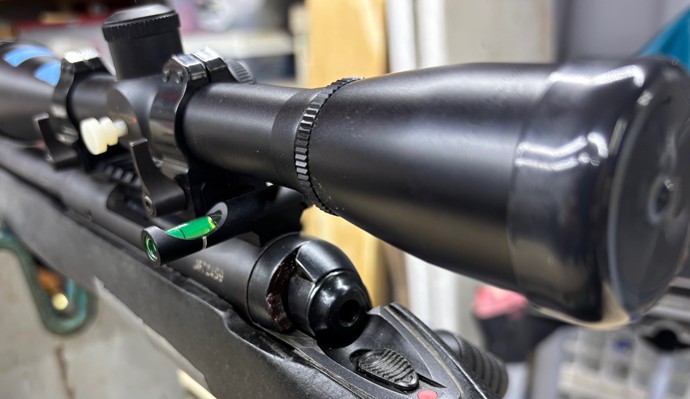

Just curious….is the use of a scope level another useless accessory? The influence on accuracy is often discussed when considering canting of the rifle. There are probably some tests out there demonstrating the differences on the target, with and without the canting influence.

1) I hang about 20 cast bullets in an old plastic Sierra jacketed bullet box, on the 100 yard backer with a piece of yellow rope.
2) I level my old Sinclair front rest with a bubble level I mounted on front.
3) I level the rifle with a low mount bubble level mounted to the Picatinny rail portion closest to the stock to where I can easily see it.
4) Rotate the scope until the vertical crosshair aligns with the yellow (has to use yellow nylon rope as white nylon rope gives you unexplained fliers), then tighten down the rings.
The rope deal only needs to be done which a newly mounted scope. The front rest and rear bag has to be done every outing.
One side note. In all the years I’ve been shooting groups it takes 10 or so shots to settle the bag to rifle fit. You have to pay close attention's to the Picitanny bubble level during the settling in process. Which means that during the first couple groups you have to glance at the level to make sure the rifle has returned to battery. After your first or second record group things settle down.
Also always use the rubber soles bench protectors and always keep a bottle of water in your front rest box to keep water between the bench top and your front rest tripod legs as well as your rear bag. Keeping the bottom of the rear bag wet is critical (so it doesn’t move), but the applies to the front rest protective feel as things get bumped around during a match. Use magic marker to circle the pads and the rear bag to give you a visual check as the day goes on. I even mark the rear bag where the rifle butt should stop at.
You can skip that last bit about water to keep your rear bag from moving when it gets below freezing. I had a memorable Sunday morning first match once while the rear bag slid around on the ice I’d created on the bench top. Bill C
RicinYakima posted this 03 April 2025
I put the action in the vice on the mill table and use a small machinists level to adjust the rails the bolt runs on to the center of the earth. Most good scopes I have worked with will allow you to put the level on the scale under the turret and rotated the scope to level.
But in reality, I don't hold the rifle that perfectly on the bags and my shoulder. So, I loosen the scope ring and while in my most comfortable position, rotate the scope till it "appears" level to my eye. That is what works best for me.
Tom Acheson posted this 03 April 2025
 Stan,   This is like talking to (5) lawyers and getting (7) answers.   Those items you mentioned may or may not be “perfectly perpendicular to the world”.   Attach the scope level to tube of the scope but don’t tighten the level.   First we need two parallel surfaces on the gun’s action or the flat on an octagon barrel, etc. For the raceway on a bolt action, Weaver sells a baby level that straddles the parallel surfaces. Or possibly a small machinist’s level? Secure that device to the receiver (might be magnetic?).   Then set the gun on a couple of firm but slightly flexible stationary surfaces. Maybe two stacks of sandbags. Convince yourself that you have “frozen” the gun into position, as you watch the baby level. Now rotate the scope level until it matches the little level on the rifle and tighten it. Maybe the old red MTM gun cleaning cradle could be used? This isn’t bore sighting so you won’t be looking through the scope for this exercise.   The challenging task while shooting is to avoid looking at the target uprights or the vertical edge of the target paper and “twisting” the rifle/scope to get the scope’s vertical crosshair to align with one of those site items. If you do that, you MIGHT apply the same degree of cant for each shot, but…..   You can also add a small level to your front rest unit. That would help get everybody “on the same page” during your set up efforts before shooting.   Tom

I must be missing something here. Is this more complicated than;   1) Leveling the rifle platform horizontally (in my case using a bubble level mounted on the Picatinny rail) and then   2) rotating the scope to align the vertical crosshair by whatever means you choose (not a telephone pole or the backer frame, something that legitimizes a gravity guaranteed 90 degrees to earth) so that the vertical crosshair is 90 degrees to your rifle platform?   My personal choice is the offset bubble level on the Pictatinny since the in line one only works with very high scope rings.  And even then its not in the top 3 three things I focus on before pulling the trigger.  Its used as a reference only.  Keeps me in the middle of the road.      But not everyone has a Pictatinny rail.  And with that observation I may have answered my own question.  Sorry for assuming.  Bill C.

I first mount the rifle barrel in a padded vise, level action with a line level across scope bases, next mount scope with loose rings, put line level on scope caps adjust level

I have also remove bolt and place offset level across magazine cot and then across bases. works if bases are mounted properly
