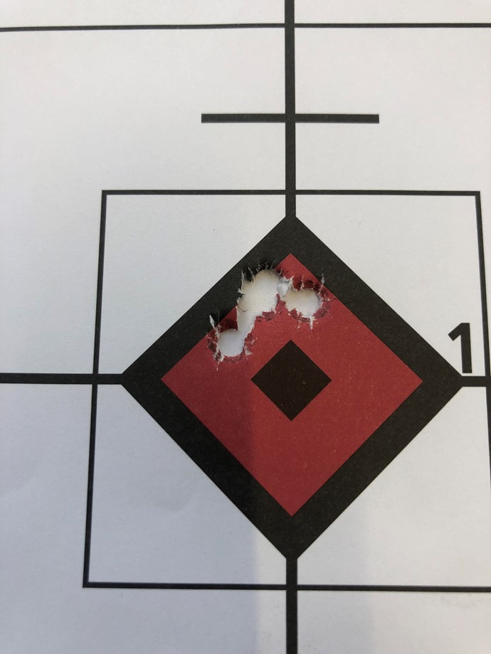

My .257 Roberts Ackley Improved shoots very well with it. Only 50m/55y but shows the point.

Nice group there Jeff.  Do you remember the % of case capacity you were using?
