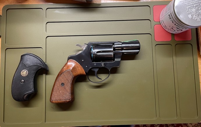

A couple weeks ago I won a Gunbroker auction from a local FFL for a 1974 Colt Detective Special. I've generally been a S&W guy but wanted a DS and was able to get it for $505 + PA's 6% sales tax. Since I was able to pick it up in person I didn't have to pay a transfer fee.
It came with a set of Pachmayr Compac grips but I found a set of period correct Colt wood stocks on eBay and got them for a reasonable price.

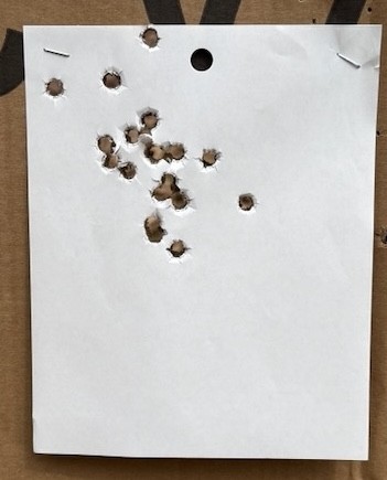

This weekend I was able to take it over to a friend's property and shoot it. This target shows my first 18 shots, fired 2 hands, double action from about 10 yards.
The ammo was a Lee TL358-158 SWC over 3.8 grains of HP-38, in mixed brass, and sparked by Servicio Aventura primers from Argentina.
With these grips I found that the knuckle of my middle finger got whacked a bit by the back of the trigger guard. I will probably try shooting it with the Pachmayrs, but I'm inclined to stick with the wood grips because the gun is more compact with them. I'm able to easily conceal it in my front pants pocket inside a DeSantis Nemesis holster.

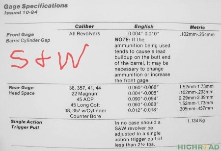

Ed Harris posted this 24 May 2025
I have found TiteGroup and Bullseye track together for velocity at same charge weight. Difference in means is less than sample standard deviation in single digits. B-C gap affects velocity too. A min gap of pass 0.004 / hold 0.005 in a 2-inch snub beats a 4-inch at max pass 0.008 / hold 0.009. S&W may ship up to 0.010".
