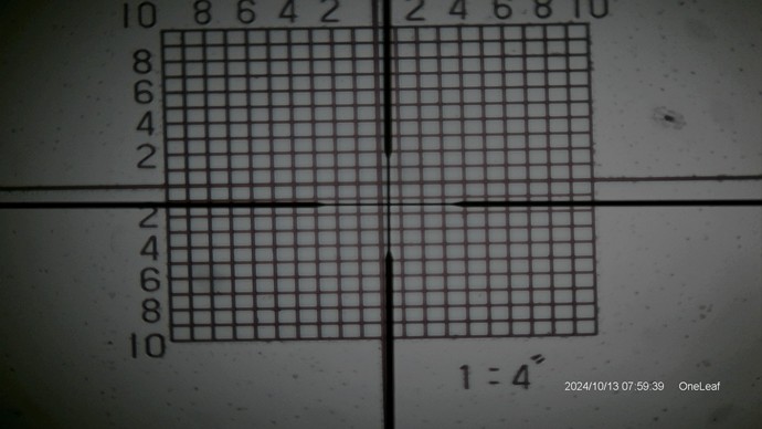

One of my better equipment buys has been a Tasco Shot Saver boresighter with a 4 minute grid. Once I have zeroed the rifle, I record the boresighter setting. If subsequently I take a tumble or otherwise come to doubt my zero, I can check for scope movement with the boresighter. If the scope is off then I can deal with it. Otherwise I just keep on shooting with confidence restored.
This system is not totally precise, but it will pick up displacement of more than a minute or two. Scope needs to be on full power (7X) for the check. System does not apply to iron sights.
I’m sorry the image is a bit dodgy – another recording experiment with the NV device on the back of the scope with boresighter in place.
