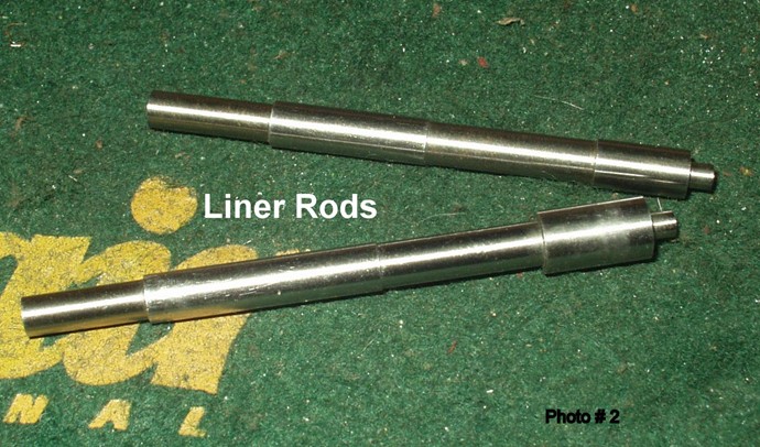

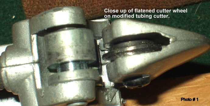

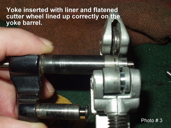

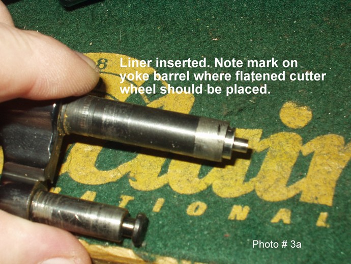

After speaking with Tim over the phone it was determined that he had several issues, but not all of them that could affect the tightness of the revolvers. So I will cover each one, one at a time, explaining the issue, how to recognize it and how to resolve it.  1) Yoke endshake - This is where the yoke has back and forth play in the frame. To determine whether this condition affects your S&W revolver, remove the cylinder from the gun and replace the yoke in the frame.  As a side note there is only one proper way to remove the cylinder from the gun. Remove the sideplate or frame screw that retains the yoke/cylinder assembly. Turn the gun back over so the left side is facing you and depress the thumbpiece so it releases the cylinder. Now open the cylinder and hold it in place while you slide the yoke off the cylinder and the frame. Now you can just lift the cylinder assembly up and off the gun. This prevents sliding the cylinder across the frame and scratching it.  Now place the yoke back in the frame and see if you have any back and forth play from muzzle to breech face. If it is excessive, then it can be corrected by replacing the screw with a larger one or simply by “peening” the screw tip. This is by trial and error, peening and filing any excessive peening until you have removed the yoke endshake. The area on the yoke where the screw holds it in can been peened also, which is how most experience smith's correct this issue. However for the amateur smith, I suggest the other methods described.  2) Cylinder endshake - This is where the cylinder has excessive play, back and forth on the yoke barrel. The way to check for this is simply to try and move the cylinder back and forth while the gun is intact. Make sure any yoke endshake is corrected before checking. To fix it properly, the end of the yoke barrel needs to be peened in order to lengthen it removing the endshake. This can be done one of two ways, but regardless of which method you choose, a liner must be placed in the yoke barrel to prevent crushing it.  The first method involves peening the end of the yoke barrel with a small ball peen hammer. This is not as precise as method #2, but it can be done if you take your time and keep the insert in place. I am not going to elaborate here on this method, but anyone wanting further instructions can ask me. Method #2 uses a inexpensive “modified” tubing cutter. I have inserted photos of the items needed to do this. The cutting wheel on the tubing cutter is removed from the cutter and placed on any metal rod just fitting through it's center. The cutting wheel is then moved up against a moving grinding wheel and allowed to grind away the cutting surface creating a flat surface around its circumference. This flat area need to be anywhere from 1/16” to 1/8” wide. Then the cutting wheel is place back on the tubing cutter. Now you have a tool that will “peen or swage” the end of the yoke barrel, lengthening it slightly to remove the endshake. The flattened cutting wheel is now place approximately 3/16” from the end of the yoke barrel, with the liner in place, and tightened as you would using a normal tubing cutter. Once it is snug in place, give the tightening handle another twist before rotating the cutter around the yoke barrel. Once it is loose after rotating, tighten the wheel once again and rotate, until loose. Now reassemble the yoke / cylinder onto the gun and check for endshake. If it is still present, repeat the swagging process until it is removed. If you over do it a little and the cylinder won't rotate freely, remove the yoke and with a wide flat fine file, make one stroke across the end of the yoke barrel and try it to see if it will rotate freely now. If not, repeat the single file strokes until it does. Once it does, wipe a light film of gun oil on the end of the yoke barrel and you are done.  More tightening of the S&W revolver is to come in part two.

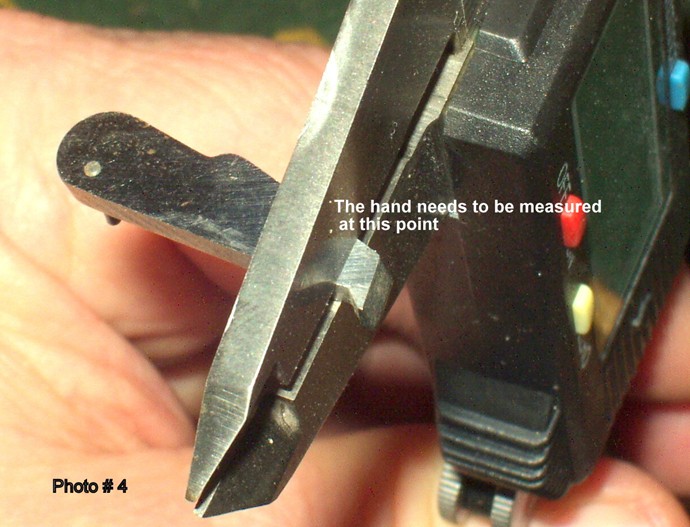

3) Timing. To check for proper timing, slowly, very slowly, cock the hammer back until it locks back in single action battery. Now attempt to turn the cylinder and see if it moves and you hear the audible click of the cylinder stop engaging the notch on the cylinder. You need to do this on every chamber. If on any of them the cylinder stop does not engage the stop notch and the cylinder can be turned further into lock-up, then you have a timing issue. This can be solved by replacing the hand with a slightly larger or oversized hand. For example “K” frame hands usually run .091” to .095” and one just .001” to .002” larger will most times solve your timing issue. Hands are measured as shown in the photo below, just below the hook.
