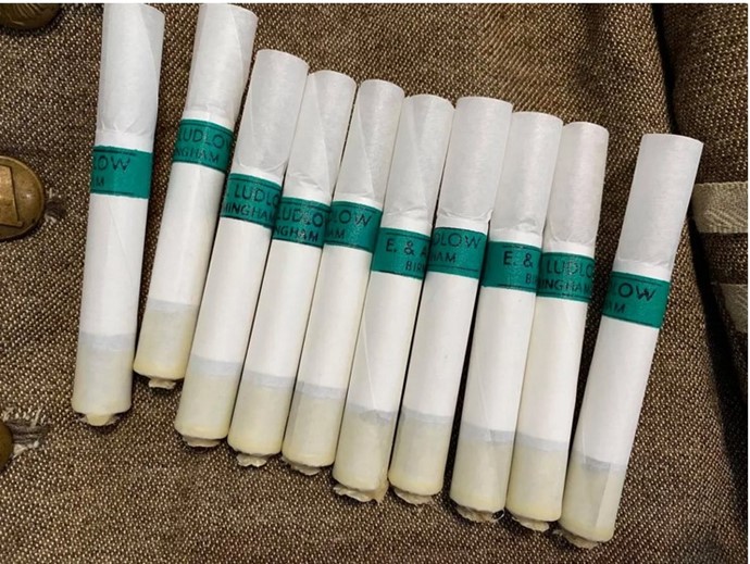

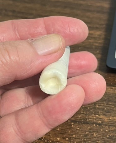

Did you roll them with a tucked tail or with the button (tied) tail?
Tucked Tail (568 bullets)
Button Tail (550 bullets)

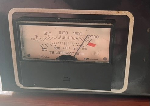

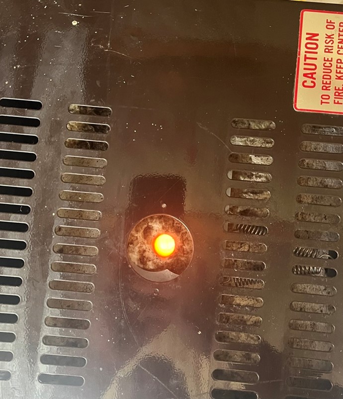

I have about 300 clay plugs firing in the furnace. I put them in there at half 10 this morning and will shut the furnace off before bed tonight. Should be cool in the morning and I'll see how the plugs hardened. Eat your heart out Brett Gibbons!
Aaron posted this 12 April 2025
Gave them a 2000 degree soak for 5 hours. Should take 4-6 hours to cool down.
Fingers crossed.
