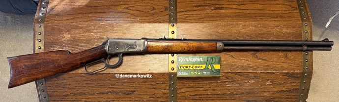

Last week I got this 1935-vintage Winchester 94 rifle in .30 WCF (.30-30). Mechanically the gun is perfect and the bore and crown are in great shape. When I did the transfer at my FFL I also bought 2 boxes of Remington 170 grain Core Lokts so that I'd have some loaded ammo.

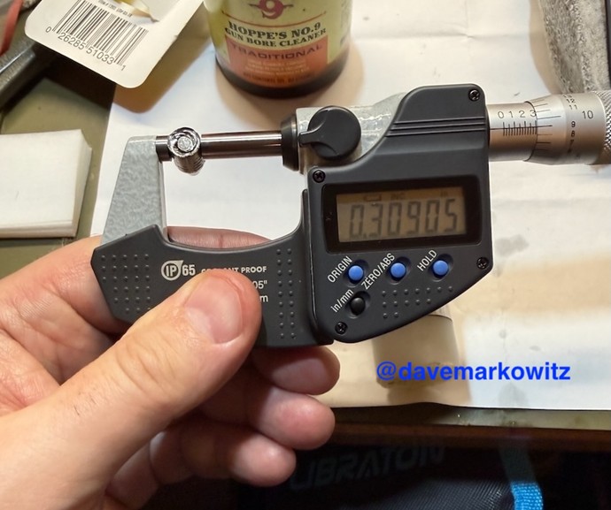

I slugged the bore and it mic'ed .30805".
I also acquired a set of dies, Starline brass, a box of Hornady 170 grain Interlock JSPs, some powder coated 178 grain bullets cast in No.2 alloy in a Lee mould from MOD Outfitters, and have a pound of IMR-3031 and well as most of a pound of Reloder 7.
I'm hoping to take this out deer hunting in Tioga County, PA next Fall. Obviously, the Remington factory loads will work just dandy for this but I'd also like to develop a cast bullet load suitable for deer hunting.
For those of you who've hunted whitetail deer with a .30-30 rifle with cast bullets, what mold and alloy do you like?

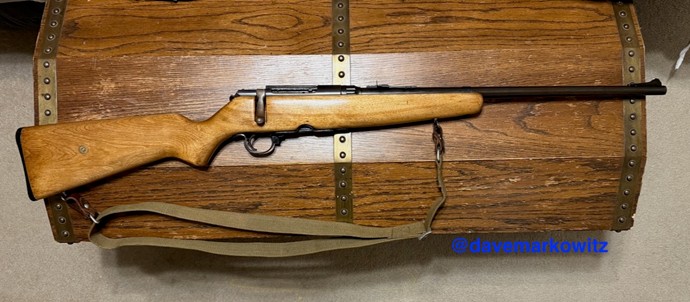

Welp, I have another .30-30 to load for. I went to the Oaks, PA gun show today and a Stevens 325B followed me home. Overall it's in excellent condition with a great bore and crown. I setup a search on eBay for an original Savage-Stevens peep sight, for which it's drilled and tapped. It's not D&T for a scope. Another option would be adding a short section of Picatinny rail on the receiver ring and then mounting something like a Holosun micro-red dot sight on it. (I like the Holosun dots because they give me a crisp reticle even with my astigmatism.
I slugged the bore with a .32 caliber pistol bullet.
I ordered a couple spare magazines for it from Numrich. The sling is a Chicom SKS sling that I bought at the gun show.
I'm looking forward to trying this with cast bullets.

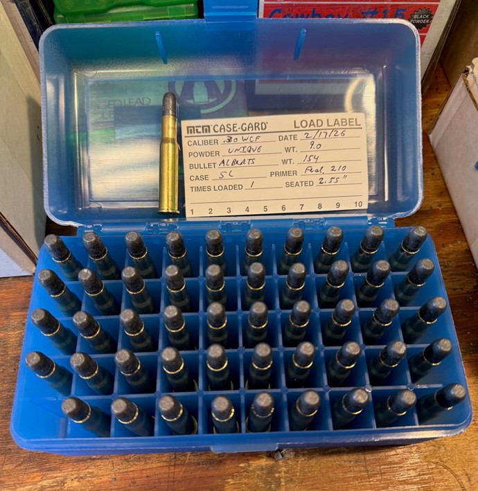

I put together a box of plinking rounds today using some 1990s-vintage 154 grain Alberts Scheutzen Plinker bullets over 9.0 grains of Unique. I figure they'll do around 1200 - 1300 FPS from the Stevens. My late father had the bullets in his stash and I got them when my brother and split up his things a couple years ago.
They should be fun for paper punching and banging the gong at my club.

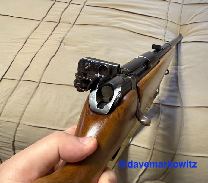

There are several Savage 340 sights on ebay right at the moment , they are high but available . Make sure you get a complete one as there are a couple on there that are missing parts.
  • davemarkowitz
davemarkowitz posted this 20 March 2026
Thanks Eddie. I did find an old WFC peep on eBay and got it. I still haven't gotten it to the range yet. Too many irons in the fire.

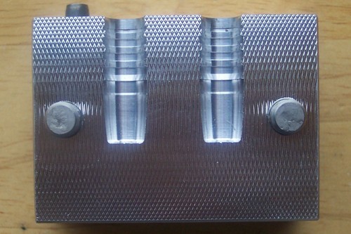

This is the bullet , Arsenal LBT clone 311-176 GC LFN . I'm thinking I might send it to Eric to have it fitted with a set of cup point and flat point pins . I don't have LVR and am awfully low on 4198 and RL7 but I do have the Varget and 748 as well as most anything else normally found to be useful in .30-30 and .32 WS so I suspect finding a load will be no problem . Veral's long flat nose series has a good reputation for being good quick killing bullets so I suspect this direct copy will do the same.
