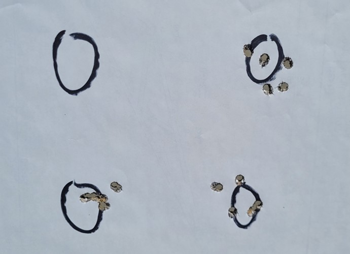

This is typical with my Ruger #1 30-06 breech seating a 211g Pope style baseband bullet.
Ive tried different powders, speeds and various things and it still happens. The bullet  length is within stability range according to many calculations.
Just a mystery to me.
I have a 6.5 Carcano shooting plainbase that also tips but groups well even at 200 yards.

linoww posted this 19 April 2025
I don't remember the velocity but they were still above speed of sound at 100 according to a Labradar.
But yes in the Mach .8 to 1.0 range .
one other bullet I use is a bit shorter and run at the same velocity doesn't show instability. Its just not as accurate .
in 32-40,35-40 Maynard and 33-47 I shoot similar shaped bullets in the same velocity range with not near as much tipping.

Ken Campbell Iowa posted this 19 April 2025
linoww ... be interesting to see a target of your tipping 3006 at 200 yards ... do they get better ?

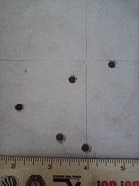

Wilderness posted this 19 April 2025
This is a phone image of five shots at 200 meters with my 1949 Marlin 336A .30-30. Bullet is #311041 about 16 BHN and 173 gns. Load is 17 gns 2207/H4198, MV 1500 fps. Calculated velocity at 200 meters assuming BC .210 is 1050 fps. Barrel is 10" twist. Peep sight.
Group was 3.03", but there is some evidence of yaw, especially for the two lower shots. The 50 meter groups that preceded the 200 meter group showed no sign of yaw.
I am theorising that the yaw I am seeing at 200 m is a consequence of the bullet coming back down through the transonic velocity range shortly before it reaches 200 m.
Lube is Javelina Schuetzen and I've varied amounts and these were just two bottom grooves.Bore is beautiful with a very slight lube star.
RicinYakima posted this 19 April 2025
Using the tables at the back of Lyman's Cast Bullet Handbook, 3rd ed., fired at 1500 f/s it is 1147 f/s at 200 yards, not meters. Lyman's is calculated of BC of .220, but not shot over equipment at that range. So in the trans-sonic range at least, but bore conditions with light charges of 4198 can also need looked at.
John Alexander posted this 19 April 2025
I wore the barrel out on a Ruger #1 in 223 and my best bullet and load and for the whole time had a bit of yaw like yours. I learned to ignore it and was happily competitive.  It make measuring the groups a bit weird but that was the scorer's problem.
If it works why monkey around with it?

Tom Acheson posted this 19 April 2025
I often see this when scoring 200-yard targets during our CBA matches. Sometimes the shooter doesn’t even know his load is doing this until we show him his target.
pat i posted this 19 April 2025
Don't get me wrong I love Accurate molds but I've had the same problem with every 30 cal plain base mold I've gotten from him, 5 to be exact, except a short 165 grainer. I have to believe that at pb velocities the wide meplat is what's causing it since I have no problem with tipping using the pointed bullet I shoot now. With a gas checked bullet running 1800 or so I'm sure the tippers would go away but that's my experience and my conclusion.
