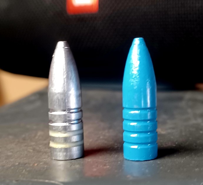

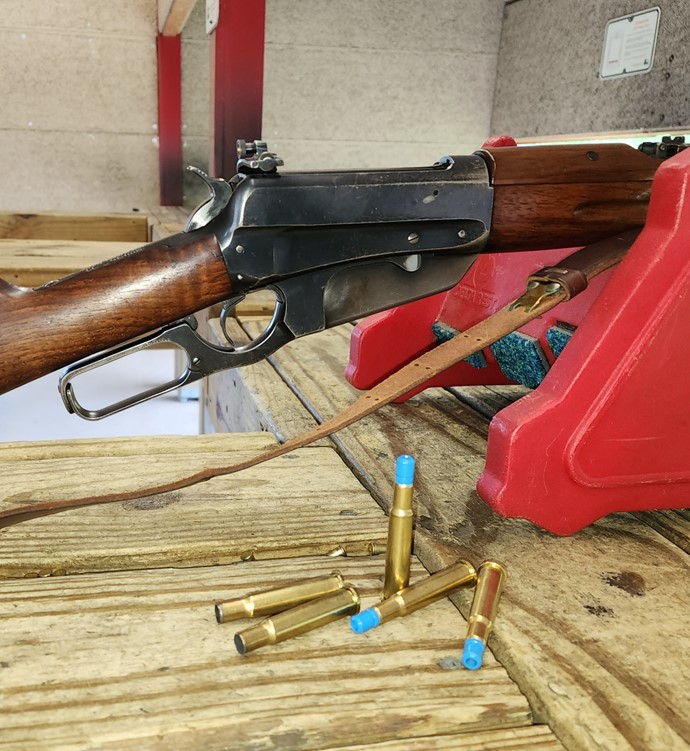

sluggo posted this 22 March 2025
  • For me the eastwood ford blue powder has worked the best so far. I tried the harbor freight red and black and had trouble getting consistent coverage. With my 30-40 loads I found i could run a softer cast bullet faster without leading up the barrel. This might be helpful if you want an expanding bullet. As far as accuracy it was about the same as uncoated for me. The bore was an easy clean up after using the powder coated pills?, slugs?, caps?, boolits?, hollapena's?, oh yeah bullets. (lol

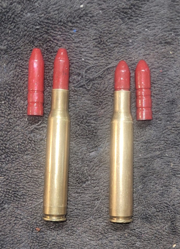

pat i posted this 23 March 2025
I don't use bore ride bullets and taper them a bit for a better fit so adding a couple of thousandth is no problem for me. Both bullets in the picture are sized and tapered.
linoww posted this 23 March 2025
I should have tapered the two I pictured for a better fit in the throat. I got lazy
what mold design and maker? Good looking bullet Pat.
It's a NOE something or other. Can't remember offhand. It's a plain base and I've had off and on luck with it.
