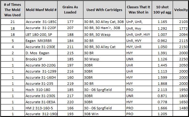

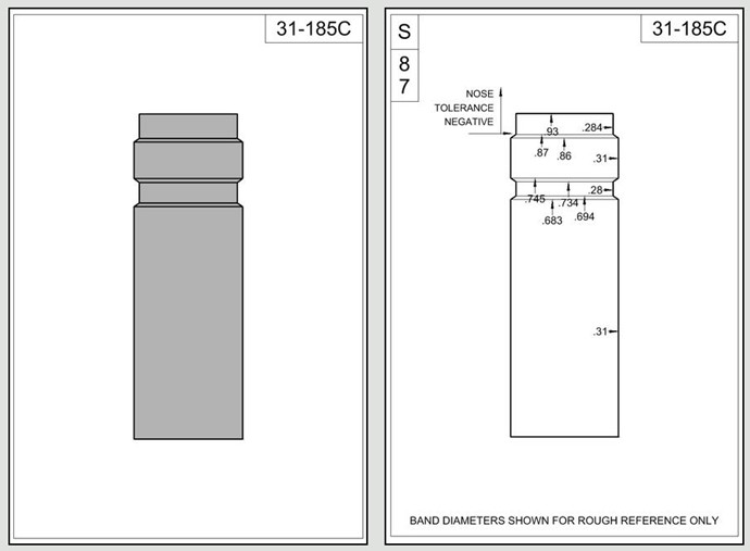

I was goofing around and was looking for molds that were popular for the 30 cal.  Long story short of the 78 molds were used from 21 to 2025 CBA Nationals, Accurate's 31-185C was the most common with the Accurate 31-220Fand several different LBT molds from 180 to 200 grain coming in second and third.
I must be missing something because from Accurate's website the 185C showed a flush nose. Its hard to believe that profile can shoot 21 ten shot 100 yard aggs that averaged 1.165.  What I expected was something more like their 185S but with a conical nose like their 210, 220, 230 boreriders.  Daniel (previously Tom) had sold 47 of of the 185S. So that looks popular.
Just had eye surgery yesterday and it still didn't help.  I still can't see the 185C profile averaging over 2100fps with 21 different ten shot aggs that averaged 1.165"  Could you help me out.
Below that is a breakdown of the 2021-25 30cal molds, their weight, the cartridge, their velocity and their 10 shot 100 yard agg.  Thanks, BIll.

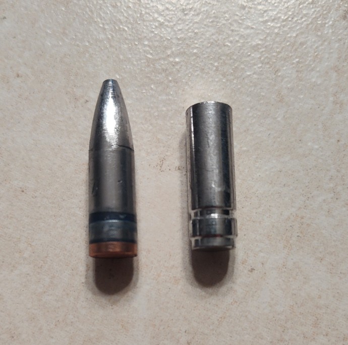

Mr. Cook,
Attached below is a photo of the Accurate 31-185C bullet as cast, and next to it after being bumped and pointed. At this time the CBA'S President Dan Hisle is probably one of the biggest makers of this particular bullet. It shoots exceptionally well, but the forming process is tedious and expensive to set up.
Hope this clears up some of your confusion

Wm Cook posted this 09 January 2026
Well I’ll be darn. I’d never would have connected the dots to get that answer. And there were fourteen different competitors that contributed to that 1.165agg.
It must keep Dan pretty busy with being president, handling life and still have time for bumping/pointing bullets enough to supply that many shooters. Thanks for that. Bill.

Do you know why it makes sense to start with a cylinder instead of casting something closer to the final shape desired so less alloy would have. to be relocated in the swaging process?

Jeffrey54776 posted this 09 January 2026
John,
In my mind, the excess of material with cylinder helps eliminate any void space in the bullet as you are pointing it up, as well as supplying enough material to make the longer length.
Jeffrey Sechrist CBA Webmaster

Shopdog posted this 09 January 2026
It is durn near impossible to cast perfect ogives. The Eagan truncated noses being an exception.

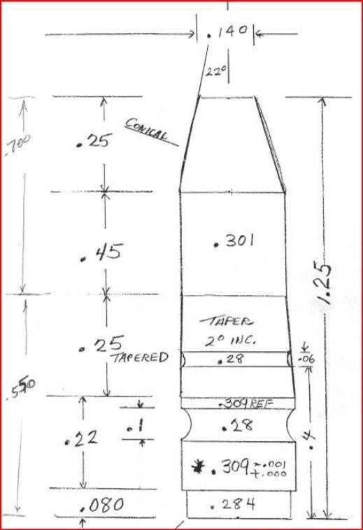

Does anyone recognize this drawing.  I picked it up along the way when I was doing some research on the Egan design.  Bill.
pat i posted this 09 January 2026
I think that's an Ardito design. Used to be pretty popular but you don't see them used much anymore. Forming that bullet pictured is pretty ingenious but just makes you miss LBT even more. Maybe Dan can come on here and show his tooling and process or write it up for the FS.
max503 posted this 09 January 2026
I was thinking how effective that blunt tipped gallery load would be on rabbits.
lotech posted this 09 January 2026
That's an Eagan MX4-30 ARD, 212 grs. linotype.

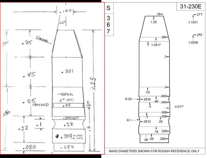

Thanks for that Lotech.  But is there much difference between that and Accurate 210E and 230E?

I sent the prints to accurate to have a Mx-4 ardito made and it came out the 310230e
