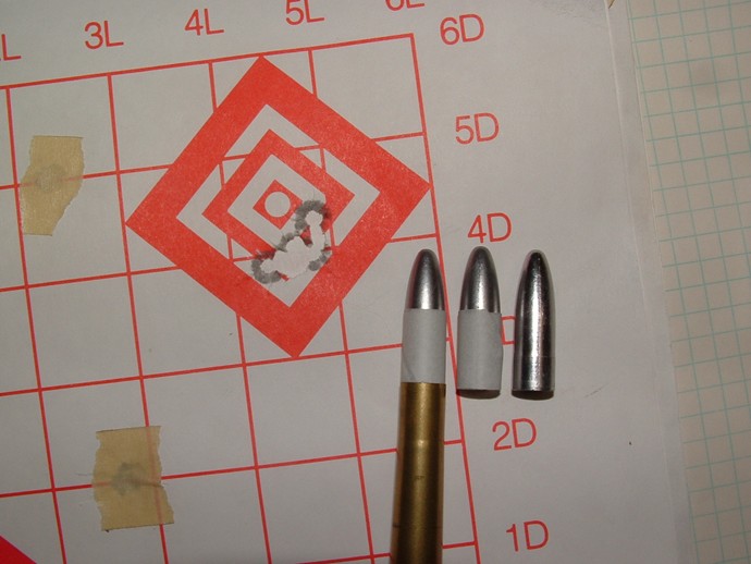

How about this kind of grouping with PP bullets at 100 yds.  Also
did 3rd place last yr at ISSA Schutzen Regional shot at 200 yds.
My 40-65W  with a PP bullet cast of 9+1  WW/Lino.
over 74.5 gr Swiss 1.5 BP
Velocity 1400 fps
Bump up not necessary with the right bullet dimensions.
beltfed/arnie
beltfed posted this 25 April 2017
Oh, that group measures about 0.6” center to center.
beltfed/arnie
