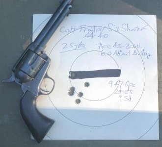

Savvy Jack's .44-40 page is the Bible. I have had best results in my several .44-40 rifles and revolvers using soft bullets and the faster burning pistol or shotgun powders. I am still using 452AA from the 1990s, but WST is the powder which replaced it and works well.
For a full-charge hunting load for the 1892 Winchester and modern clones 20 grains of 4227 works well with up to a 240-grain bullet. Also OK in Rugers and modern Italian Colt single action clones.

Ed Harris posted this 19 August 2025
WST and 452AA can be safely loaded at the same charge weight as Bullseye. Velocity will be a bit lower, but the result is a safe starting load. If desired you can work up carefully over a chronograph to reach your desired velocity, but I have not found doing so necessary. A charge of 6.0 grains with either under a 200-215 grain bullet is where I usually end up.
Six grains of Bullseye is a full charge load for pre-WW2 revolvers.

Ed Harris posted this 20 August 2025
In modern rifles and revolvers you can go up to 7 grains of Bullseye with up to a 240-grain, as pressure tested by Larry Gibson. With 200-grain bullet it is a safe full charge load for post-1920 Colts which are heat treated and any of the '92 Winchesters.

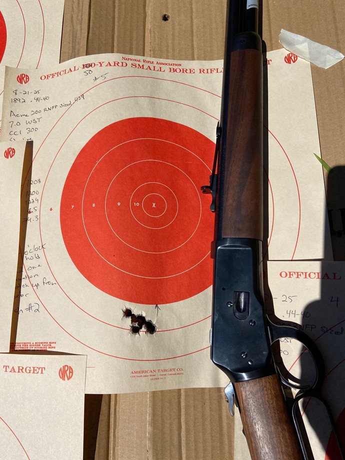

So far today’s progress was following your suggestion.  I loaded up a series of work up test lots with WST.  This time actually sizing the cases versus using them as they came from starline.   I might start flaring more as with .429 size it’s rather close to get them started.  The store bought bevel base ACME bullets are helping in that regard though.  I am not a bevel base fan either, but in this application it has some merits.
I did also reload the 1x fired batch from yesterday with the 7.0 gr of Universal. Just to give it a fairer shot when I actually have the right glasses on and they’re actually sized and even better fireformed.
I wonder how much the lack of fireforming in the brass is affecting my work ups.  Not that I don’t go back and repeat them before making a big batch of ammo.
My club’s indoor range is out of order for modernization.  Today might be a good day for some indoor work if it was done.
So the next break in the weather won’t be today or tomorrow.
Lance Boyle posted this 21 August 2025
Well first off many thanks to Mr. Ed Harris.  I think he knows a thing or two.  Since I didn’t have bullseye and you suggested WST was a pretty good substitute I tested it out today.
Not too shabby, I think my fun load is mostly there now!
I shot another batch of the Universal powder load, this time with my single rx glasses on instead of the progressives.  Meh.
I then shot WST, 6.2 grains, 6.5, 6.8 and 7.0.
6.2 average 1123, SD 2.9, ES 8.5
6.5 average 1156, SD 7.4, ES 19
6.8 average 1186, SD 8.8, ES 26.6
7.0 average 1208, SD 8.5, ES 24.3
The 7.0 was the winner of the day with a 1.25” group.
Young fellers,….listen to those that have been down the path before you!
To be honest the 7.0 group may have an unfair advantage as the speed increased my impacts were getting closer to the bottom of the paper so I changed two things, I move the rear sight elevation up to step 2 and also because of my eyes shifted to a six o’clock hold.  My eyes were a little troublesome holding the center mass hold as the right side of the target would appear to fade or wash out. Cataract issue I suppose.
Maybe I’ll repeat the test for the top two charges.  I need to change the primers anyhow.  I had one CCI 300 pierce.  After I had started with those primers I found that I had some winchester Large Pistols that should be a bit tougher.  Sadly I gave 900 CCI LP magnum primers to a friend that asked for some.  At the time the only LP primed cartridge I used was .45 ACP. oops.  I know he hasn’t used them, maybe I’ll beg a few packs back.   oh and the charge that pierced? the lightest load, 6.2 grains.
(Edit- CCI 300 primers were my older stocks in light buff almost white sleeves over the smallest trays that have ten primers lying on their sides in the long slots, not single primer cups)
Again, many thanks to Mr. Harris!

Well so far the .428 sized Acme 200 with 6.5 grains of WST and the Redding Profile crimp didn’t wow me.  A fist sized fifty yard group.
I will work it up toward the 7.0 load again.  I was hoping to get a accurate load at a little lower speed.
Anyways the Acme .428 RNFP in once fired starline, sized in the Redding die set, Redding expander, Redding seater without crimp and finished with the new profile crimp die (which drew the bullet in and gave OAL of 1.580) yielded an average of 1137 fps for 15 rounds and a SD in the 8’s.  4+ inch group though.
I did like the more relaxing level of loading the smaller diameter bullet and enjoyed the use of the profile crimp die.  Now just to see if there is an accurate load down that path.
If that doesn’t work then it’s back to 0.429 or 0.430 bullets. I’ll need a .44 mag expander if I end up working down that direction.

Lance Boyle posted this 28 August 2025
Just some more data points
Acme (Magma) 200 gr .428” RNFP Bullets, Starline Brass, CCI300
6.0 WST , Av 1069, Lo 1058, Hi 1092, SD 10.5, ES 34, The only ten shot group  4 1/4”:
6.2 WST, Av 1100, Lo 1092, Hi 1107,  SD 5.6 ,ES  15.7,  3 1/8” group, 4 in 1 1/8” knot
6.4 WST, Av 1123, lo 1117, Hi 1134, SD 6, ES 17, 5” group
6.6 WST,  Av 1147, Lo 1137, Hi 1159, SD 7.9, ES 22, 3 1/8” group
6.8 WST, Av 1175, Lo 1169, Hi 1181, SD 4.9, ES 12.1, 3” group
7.0 WST, AV 1194, Lo 1181, HI 1215, SD 11.7, ES 34, 3.5” but 4 were in a 1 5/8” knot
7.2 WST, Av 1215, Lo 1206, Hi 1227, SD 6.9, ES 20.7,  3” group
and one that is an oddball with a few 0.429 bullets I resized from .430
6.0 WST, Av 1105, Lo 1092, Hi 1109, SD 6.5, ES 17.4  4.3” group
notes
I find shot number one is often a high shot of a group or even the group breaker.
while the center of a group or preponderance if impacts were close to my sights with a six o’clock hold and impacts mostly at or near the point of impact, only the 6.0 load shot the center of its group above the x ring (still a 6 o’clock hold) and 5” above the sight hold..  All other groups including the oddball 0.429 bullets with 6.0 WST shot to the sights or within 1.5” of the sights.   I did not mix up the 6.0 WST loads between the .428 and the .429 size bullets.  They were on opposite sides of the ammo box and I wrinkled one of the .429 sized bullet loads when I tested them in the profile crimp die and I examined said wrinkled case immediately before and after firing that shot. Oddly the odd size bullet load was a “better fit” then the one of the same charge with the 0.428”  bullets of the test series.
In the last couple years I am pretty tentative making judgements on groups with iron sights and my old man eyes.  I have bad days and good days depending on light and eyeball cooperation.   This session didn’t seem all that bad eyewise,  The light highlighted the brass bead and put a slight glint on the edge of the rear U notch.   Granted the light conditions changed a bit with passing clouds.   Ah the struggle of aging.
Another thing yesterday I tried to track down the .44 magnum expander as Redding does not sell direct.  No one seemed to have the expander stem only in stock.  I called up Redding and got a tech and explained that there was nothing wrong with the die but I was trying to load for my bore of the more modern dimensions.  He was glad to drop a .44 magnum expander in the mail,..gratis.  I tried to pay but he said it wasn’t necessary.  I’ll be in good shape soon to resume 0.429 and even 0.430 sized bullets.
I am trying to narrow down what diameter is best before buying a mold.  I suspect that a 0.429 or .430 is going to be where I end up. (as I always expected after slugging the bore)  I think anything that comes out the front is CAS accurate but probably not silhouette accurate.  It seems 98% of bullets offered are CAS grade, I seem to cull a fair amount out of the box with commercial bullets.  Mostly a bit of hardened slag on the bevel bases of the Acme bullets.
Well that is my update for now.  Hardly anything ground breaking here.

If you get serious about casting, get the Accurate Molds 43-215C by John Kort. It is basically a copy of the 427098 but incorporates a crimp groove.
I got the 43-214A made to mimic John's 43-215C, but removed the crimp groove and reverted back to the smokeless lube grooves.
If you want the lead to expand in the bore, ya gotta use softer lead and closer to max pressures.
