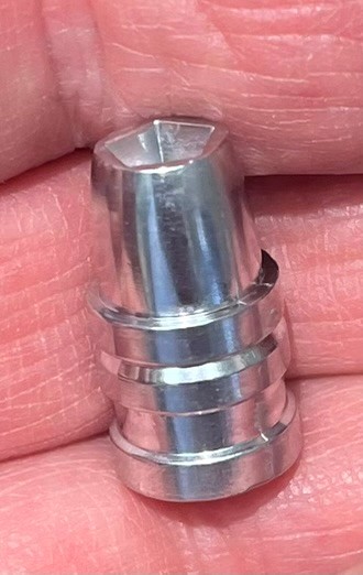

Heated the mold up today. It casts beautifully of course. Took a while to get to optimum casting temp due to it being brass and a 4 cavity. My left forearm looks like Popeye now.
Mold casts at .4145 With Lyman #2 alloy. Bullets weigh 208gr with the star spud inserted

Very nice. Would you mind telling what you size them at? Thanks

Those came out looking great.

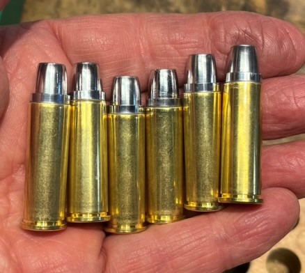

.410" since it's the only size die I have for the 41. Can't seem to locate a .411 or .412 size die. Fortunately the cylinder mouths are right at .410 - and I mean .410".

Aaron which firearm are you shooting those nice bullets from?

Aaron posted this 04 March 2025
A Ruger NMBH and a S&W Model 57. And a T/C Contender.
