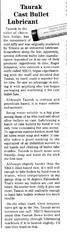

As part of an estate purchase I ended up with 9 sticks of the above titled bullet lube. Is anyone out there familiar with it. Haven't been able to get any definitive
information online.
Neco Bullet Lubricant (Taurak) water soluble

NECO Bullet Lubricant ceased production at least two decades ago. It is good lubricant. I've used it for match level loading.
Like many lubricants, they ceased production about the time I wanted to lay in a good supply.

I started using Tom Gray's #24 in 1997. He eventually stopped making it. Got lucky, ran across a guy who had a bunch and was getting out of shooting. So I bought him out of the lube.
it was just Choo-Choo train "hot box" break lube .I still have a block of it.
Good stuff,kinda gooey and stinky.

I think NEI also sold it as "Hawkeye "

I started using Tom Gray's #24 in 1997. He eventually stopped making it. Got lucky, ran across a guy who had a bunch and was getting out of shooting. So I bought him out of the lube. - Lucky you. I wanted to buy the formula if he ever decided to quit making it. He gave the formula to Jeff Bowles who "improved" the formula and now it's out of production. I thought Gray's 24 was as good as LBT Blue which is now also out of production.
