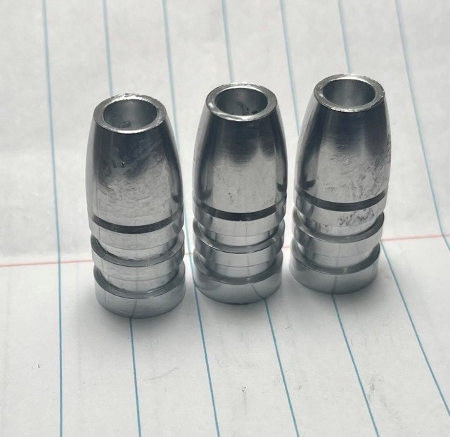

Made my first casts with the new MP 462-420 HP Mold tonight. Again a beautiful brass mold sent from Europe to NC in 2 1/2 DAYS. Heads up UPS and FEDEX.
This mold definitely likes to be fed from the bottom spout of the Lyman Mag-20 furnace. Being a large bullet, both the mold and the alloy must be super hot to cast correctly with full fill-out of the bullet. Casting with Lyman #2 alloy produced HP bullets of 380 gr at .460" on the nose. These plain base bullets are a tad heavier than the Gould Express bullet at 330gr with its rather small HP opening. These MP bullets will feed well in the lever action 45-70 guns as well. I can't wait to load some of these rascals up and test them.

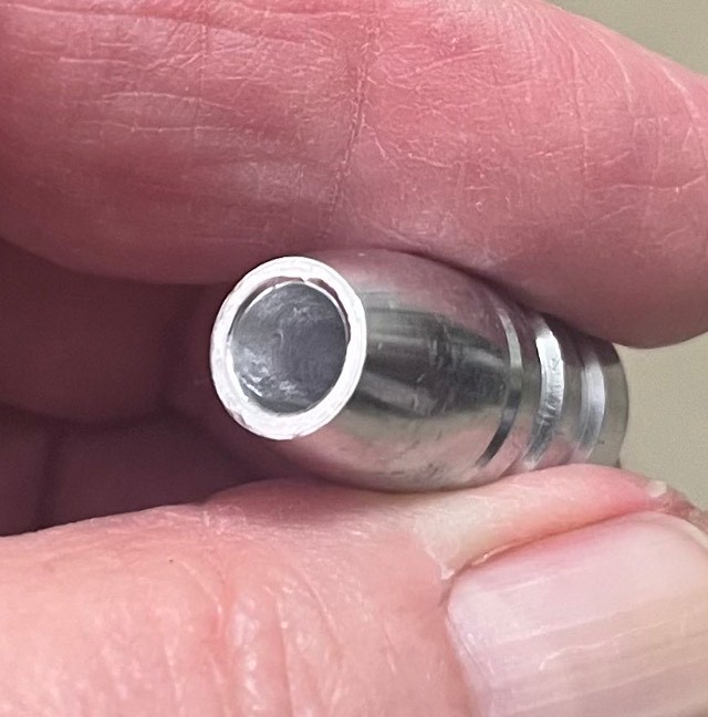

Bullet weight with no hollow is right around 460gr. With the HP, bullet is 380gr. Bullet length is 1.021" and the hollow depth is a tapered .340" into the nose.

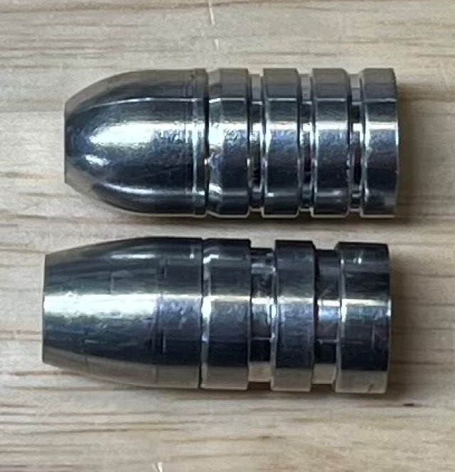

Well....dead in the water. This bullet, like the 312-170-HP bullet will NOT CHAMBER due to full diameter measurements in front of the crimp groove. To accommodate short throats, these bullets need to be BORE DIAMETER ahead of the crimp groove, not groove diameter like they are. Unfortunately this will be my last MP rifle bullet mold. Comments, photos, and suggestions were sent to MP Molds in the hope they will be used to improve the product.
This bullet may work in a long throat single shot but it won't work in a lever action rifle when the crimp groove must be used. Dang.

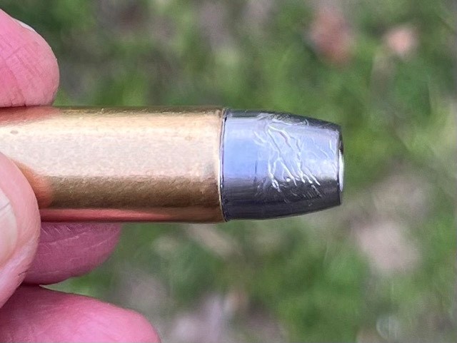

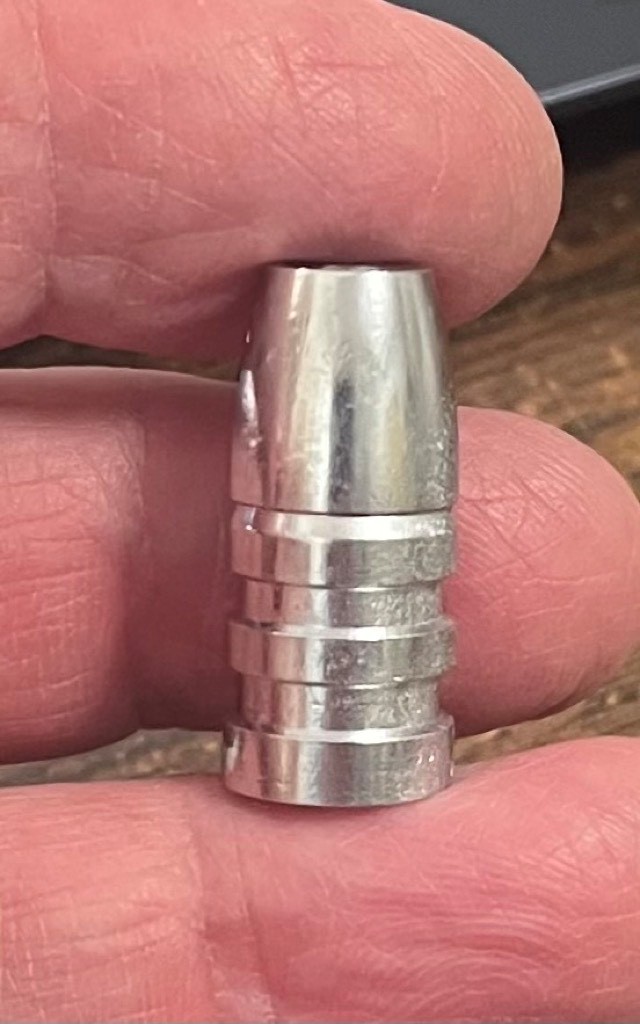

Against my better judgement and absorbing another $62 hit, I ordered a .449" size die from Buffalo Arms to size the nose of the MP 462-420 HP bullet down to fit in most 45-70 and 45-90 rifle throats whilst using the crimp groove provided in the bullet. Use of the crimp groove is essential in lever action rifles with tubular magazines. While I could seat the bullets even deeper into the case and use an aggressive taper crimp, that reduces case capacity for Black Powder loads, which was what I mostly use in these rifles.

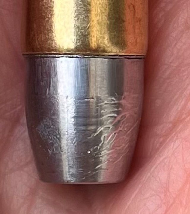

I just tried the nose reduction to .449" making the nose a "bore riding" nose profile and when cartridges are crimped into the bullet crimp groove, they now chamber in ALL of my 45-70 and 45-90 rifles. Miracle of miracles. Actually it's not. The MP bullet design is very poor. Emails sent to Miha Prevec have gone unanswered. His bullet design for rifle bullets with a crimp groove NEED to have a reduced "bore riding" nose profile to allow chambering in most rifles.
RCBS, Lyman, Lee, Saeco and a host of other mold manufacturers figured this out decades ago. Miha just doesn't get it. He also refuses to answer my email messages regarding this. Perhaps someone on this forum who has Miha's ear can point out this design flaw to him? While MP Molds are generally well designed, this particular error means the cast bullets are show stoppers when trying to use the crimp grooves. His handgun bullets are fine, but these rifle bullets need to be redesigned with a bore riding nose profile.
Below are images of the resized nose to .449" up the nose .150" above (before) the crimp groove. These now chamber perfectly. The bullet shank of course, is sized to .458 or .459" depending on the rifle. Problem solved but at another $62 expense and more time to prepare the bullet after casting.
Bullets shown are rejects from the casting batch but serve here for test purposes.

And it's actually .459 to .454 to .452 to .449" What a PITA.
