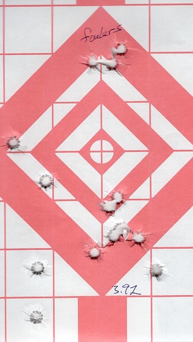

I hadn't shot my Finn M39 since the military match the Thursday before the CBA National Tournament last year, so decided I better get it out and blow out the cobwebs.  I got a scope mount that replaces the rear barrel sight and put a 6x scope on it. I loaded up three extra rounds of the first load, 20 grains of Reloader 7 with the Lyman 314299 cast of linotype, weighing 196 grains ready to load.  This was the load I shot last year.  The three extra sighter/foulers were with bullets I had rejected for minor visible flaws.  From a clean barrel, they grouped nicely at the top of the diamond.  I cranked the scope down some and then fired the 10-shot group of the same load, but with visually good bullets.  (OK, one from another load snuck in there.)  Argh!

Does it look like the bullets outside of your group are yawing a little?
Glenn R. Latham posted this 12 July 2024
Could be.  The bullet carried well to 200 yards last year and was not very wind sensitive.  I think a lot of CBs show a little yawing.
Glenn
MarkinEllensburg posted this 12 July 2024
I know the pain. have shot visibly flawed bullets at the sighter bull and usually they hit the x. Once at Springfield Oregaon that happened at 200 yards. Only x for me that day.
In March this year during warmup I had 4 shots make a nice .375" group. None of my 5 shot groups were even remotely close to that but I did pull it all together for a 10 shot screamer, hunter rifle. Followed by score with nothing worth writing about.
muley posted this 13 July 2024
well Glenn, looks like you should stick to the imperfect bullets. I do the same thing and use them for sighters and so called " imperfect cases" and they shoot well. sometimes my mind will not let me try them for record. ???

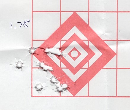

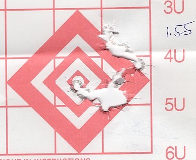

The same day I shot the above target I shot several more loads. 16 grs. of 2400 shot a 2.24" group, 20 grs. of AA LT-30 shot a 2.99" group, 17 grs. of VV N110 shot a 1.55" group, and 14 grains of Blue Dot shot a 1.78" group.  The last 2 are shown below.  I will shoot them at 200 and pick the winner.  All loads were in the 1500s for velocity.
