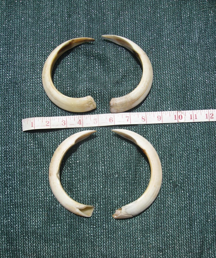

Edit 2025 - these are the tusks, all over 9" around the curve.

For what it's worth, old barrows can have some pretty impressive ivory - see edit of OP.
