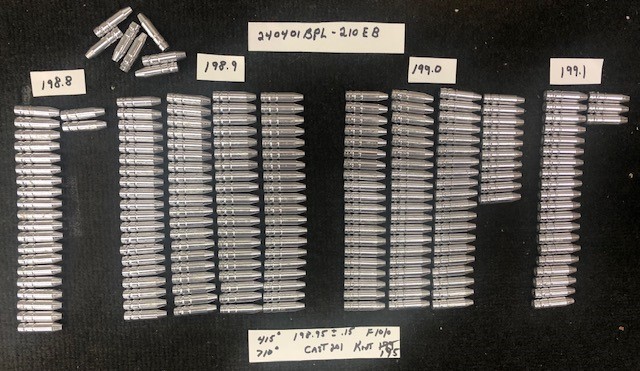

30 years ago I was just happy to have something that looked like a bullet come out of the mold. In 2022 I learned about cast BR and that led to a reevaluation on how I was casting. The first thing I focused on was casting consistency and the only yardstick for that was bullet weight. I agree with John that +/- x tenths means little to nothing but weighing can be used to evaluate your casting consistency.

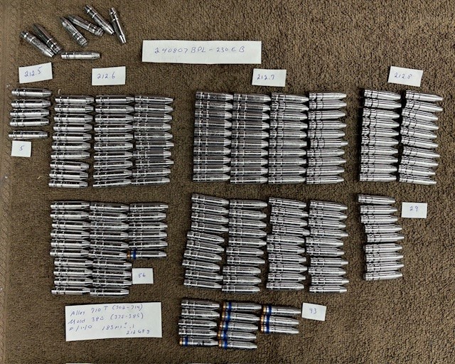

Yesterday I cast a couple hundred 30 cal bore riders with a mold temp about 30 degrees cooler than the previous cast. Two things stood out, the first being that the bullet (single cavity brass) fell out of the mold readily and the second was that I had lost some nose diameter. Enough diameter that I couldn’t feel the nose dragging on the lands.
My habit is to check mold temp every tenth drop to keep me somewhat consistent. If you drop 5 or 8 in a row that jump out of the mold the temperature will creep up 5, 10 degrees if you don’t watch yourself. Same same if you have a glitch and your cadence is hampered. If you know what you’re doing you can throttle back or speed up on the time it takes from the bullet coming out of the mold to when you start the next pour.
With this mold I go to frost then do the “count” (1 Mississippi, 2 Mississippi …) then hand cut the spruce. The time between bullet drop and starting the next pour was tweaked to keep the mold temp at the target 385.

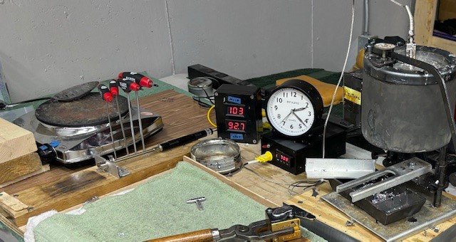

For those casters a means to measure the temperature of their mold makes sense and keeping the mold at a consistent temperature tightens up the ES of the bullet weights.  Not that .3 tenths will be seen on the target but face it, we would all like to see single digit velocity standard deviations but we can live with what we got.
Setting up a thermocouple in a fixed position is simple and adds no time to the cadence process.  My sprue's take about 6, 7 seconds to reach frost, then depending on the mold I take another 0 to 4 seconds or whatever is necessary to allow a clean cut (no tears, no divots) as the sprue is cut.  When I'm casting I catch a mold temp every tenth drop and it doesn't interfere with my cadence.  Its like glancing at your speedometer once in a while when you're driving through Kansas.  Be honest without yourself here.  Would you drive highway 70 through Kansas with the speedometer on your car taped over.
With ladle or bottom pour Linotype I can usually hit about 95 - 97% +/- .1g when I'm making a long run (160 to 200 bullets).

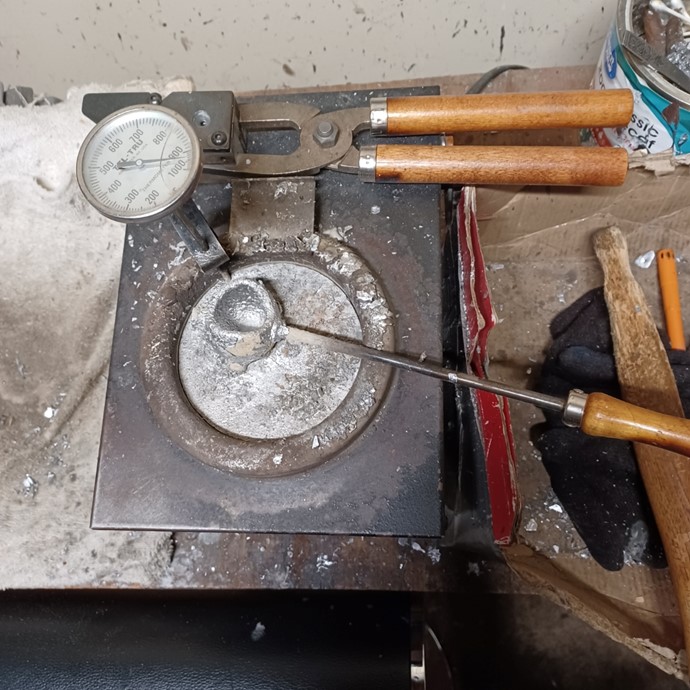

Bill I don't need to take a deep breath because how people do things is their own business. Personally I just don't find what amounts to pouring piss out of a boot overly complicated. My PID is that thermometer left in the pot all the time. Temp goes above 750 I turn the temp knob down. Goes below 750 I turn it up. 750 degrees has always worked for me no matter what the molds made out of. No idea what the mold temperature is and really don't care as long as it's throwing good bullets. When I start seeing the use of PIDs and mold thermometers showing up on people's targets I might change my mind but as of now there's a lot of records that were set before either came down the pike.

I don't know if the thermometer is 100% accurate and don't care. I'm getting good bullets out of wheel weights at a reading of 750 degrees so if in actuality it's 730 or 770 it doesn't mean squat to me and I'm certainly not going to stick my finger in the lead or squirt some in my mouth like a baby bottle to find out.
I don't know if I believe that tin burning out routine at the temps we cast at, at least I haven't noticed anything although I don't know how I would. I'm not a marathon caster so the lead isn't hot for that long and if I was unless I just kept casting and remelting the same bullets over and over again your adding tin and everything else back to the pot every time you refill the pot.
I don't know if I'm in the 10% of anything or at least I've never been told I am. As to your comment about new casters. I'm a firm proponent of the KISS principal. Start telling people that their alloy has to be at an exact temperature or anything along those lines I think it throws them off. Let people learn the important parts first and then they can start adding equipment and become more exact later, or not. Being were a bunch of old guys we learned by doing it the old fashioned way. Might have made some mistakes and had problems but we figured it out. Like I always say....this ain't rocket science.
