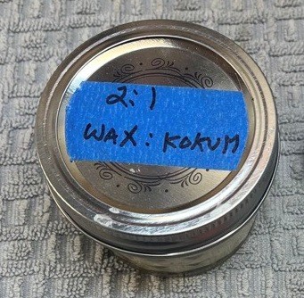

Aaron posted this 1 weeks ago
I have found a ratio of 2:1 parts beeswax to Kokum Butter works well.
