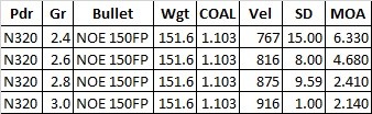

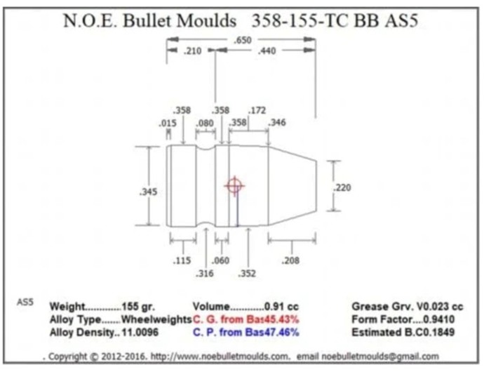

This is an apples & orange comparison to what you're using but I have 9mm Ruger PC which has a 6.5” barrel that I load using the NOE 155FP, sized .357, COAL 1.090 and 2.8g of N320 @ 875fps. 9.59 SD. It gives me thumb print size groups at 10 yards. Got all Buck Rogers and put a Sig red dot scope, a collapsing stock and a suppressor on it. Went to the trouble of setting up a Lee 4 stage progressive press (Which actually works great! Be sure you lube the turret ball track) and all that rigamarole. Sad to say it never got put into use. I can't get past bolt guns. Thanks, Bill Cook.
