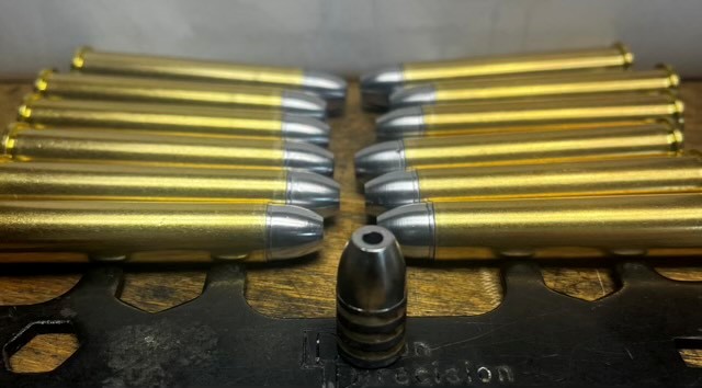

I finally got around to loading up some 45-90 cartridges for the Winchester 1886 Lever Action Rifle with some Shooters World Multi-Purpose Black propellant. There is not really a whole lot of information out there regarding it so I used the data sheet provided by Shooters World whereby they advise to fill the case to the bottom of the bullet. As you know, the MP Black is a black powder substitute propellant similar to Pyrodex in performance, or so they say.
The available literature regarding it is either 70% positive in nature or 30% negative in that it is highly corrosive, fails to ignite, yada yada yada.

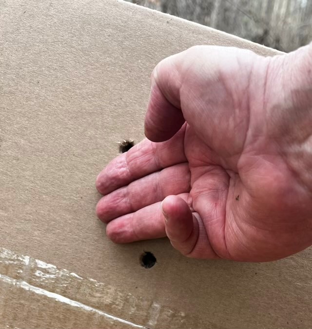

In truth, the propellant ignites wonderfully, leaves very little residue in the barrel after firing and the bore is easily cleaned with water or moose milk. With a 60gr (by weight) charge under the 330gr Gould bullet in Lyman #2 alloy, the recoil was "normal" for the 1886 on steroids. At 62 yards, offhand, with open sights, the bullets were about 3" above center and shot 3" apart. That is certainly fine for a hunting load. I am sure the group would have been better had I benched the rifle, but anyone who shoots an 1886 with a crescent buttplate knows how painful that can be.
The Lyman Gould bullet (457122) performed wonderfully. No leading was present and very little bore residue remained in the barrel. The propellant produced white smoke like using black powder. I used a taper crimp on the cartridges since no real crimp groove exists on the bullet. I also wanted to use all three lube grooves for lubricant. The Paul Matthews Premium+ lubricant worked wonderfully as well.

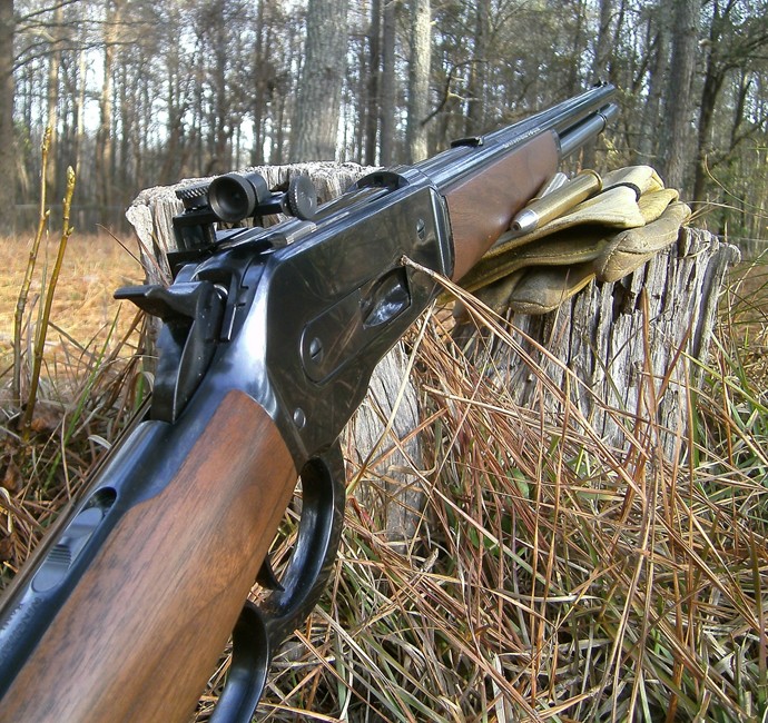

I love the eye appeal of the crescent buttplate. For me, they really enhance the lines of the Winchester lever action rifles. Shooting them offhand of course, is the only way to survive the recoil with them. I absolutely agree with your qualification of stock dimensions for the shooter. Each point is very important for precision marksmanship with a rifle. Years ago I had a rifle fitted to me by the USMC and she was a dream to shoot on the long distance targets. I tried to explain "cast" as in "cast on or cast off" to folks when I worked in the Gun Library at Cabelas for 6 years. Most folks have no idea how important those fittings can be on a rifle. That was the only rifle I had with custom stock dimensions. Since I can't afford to fly to London for a fitting on a Purdy, I use factory stock dimensions on whatever rifle I shoot. That works pretty good except for tang sights where less drop would be beneficial for a proper stock weld.
Oh well....the stock Miroku 1886 Winchester runs just fine for me now. I have no plans to work the rifle at real far targets. Around here, 100 yards or less are where most shots on game happen. There is the occasional farm field (sweet potatoes) where a deer stand surveys the field of 500 yards, but I don't hunt in them. I hunt the woodlands and 62 yards is a far shot. With the Lyman aperture sight on the rear and a gold dot on the front sight (thank you Miroku), the sight picture works just fine for 60 yards and perhaps 100 yards. Love those aperture sights!
