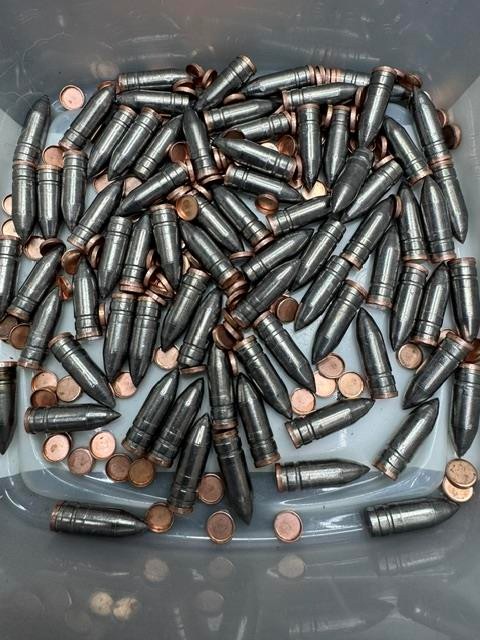

Paul Pollard posted this 08 May 2026
William,
In a conversation with Dave Lee at a National Match several years ago, I asked how he processed his bullets, since his accuracy was outstanding.
He said that he put his bullets in a tumbler, added a small amount of moly powder and threw in some gas checks. He said the gas checks would attach during tumbling.  I didn't believe it, but he assured me that it worked. On my return home, I tried it and it did work. I'll try to attach a photo of 6mm bullets and gas checks. Of 66 bullets, the gas checks attached to 51 of them in 15 minutes. Try it. It might save you some aggravation.bullets and gas checks
