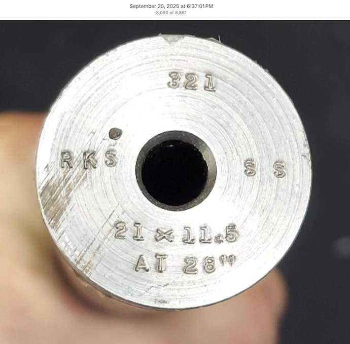

I have always wondered why the twist rate is not dsignated when a barrel is listed as "GAIN TWIST".  To me the term "gain twist" means the twist rate is "0" at the start of the rifling and gradually increases toward the muzzle.  Therefore, the bullet is spinning at a pre-determined rate when it leaves the muzzle and the barrel shoud have a  designation such as (24"-gain twist-14).

Cove: you shouldn't think of the beginning part of the rifle as "0". A Carcano is a common one that starts about 1:19 and ends at 1:8.5. So by the time the bullet spins out the bore it behaves as a 1:8.5. The slow start was meant to lower pressures and ease the bullet into a faster spin rate.
cove posted this 18 March 2026
Scott: Good point, I made the mistake of assuming that the the initial twist was "0".  With computerized machines the standard nowdays I am suprised gain twist isn't a common option for cast bullet barrels.  Especially for revolvers shooting cast bullets.  In my 38spl with a 1-10 twist barrel, recovered HBWCs show that there was quite a bit of skidding when the soft cast bullet engaged the rifling.
