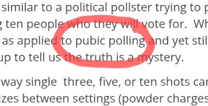

Bryan Litz ran extensive tests on tuners, carefully following the manufacturer's instruction and found that it was impossible to find the magical best setting for the same reason that "ladder" approaches for finding best wt. of powder charge don't work, as commonly done.  The single groups that are recommended to be shot at each setting (or weight) aren't reliable because the number of groups, and shots in the groups, aren't nearly enough to access precision at that setting. And it is too in time, ammo, and barrel life, to shoot enough at the number of reasonable settings that should be examined. Same reason the Tony Boyer's "tuning" and adjusting during a match methods can't work -- the sample is too small to tell the truth.
Both are similar to a political pollster trying to predict the outcome of an election by asking ten people who they will vote for.  Why most of us can understand the principle as applied to pubic polling and yet still expect a single three, five, or ten shot group to tell us the truth is a mystery.
The only way single  three, five, or ten shots can give good information is IF the groups sizes between settings (powder charges) are HUGE, and they are not. In a complete wipe out election polling ten people might  also might also be enough.
linoww posted this 22 April 2025
" as applied to pubic polling"
Not sure that was a mis-spell or intentional.It sure does represent political views!
As for your statement above, that's how I felt for a long time.I'm gonna save your comments.Because you explained it much better than I could have.
John Alexander posted this 22 April 2025
"Not sure that was a mis-spell or intentional.It sure does represent political views!"
=========== George,
Wouldn't be a surprise if mis-spelled, but I have no idea why "public polling" represent a political view. I certainly didn't intend for it to imply any such thing.
I need help.  How does it represent a political view?  What political view does it represent? Thanks.
linoww posted this 23 April 2025
you wrote "pubic" not "public"
I was trying to make a funny.i thought " pubic polling" was a survey question to assess your gender when.you join the Democratic party
