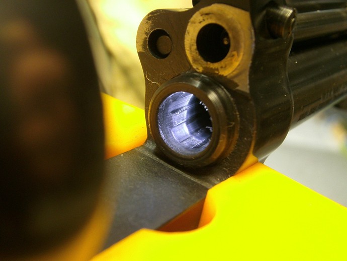

I cut an 11 degree forcing cone into my 41 Mag revolver today. I have done this with some of my other revolvers and noticed an improvement in group size. Of course this works best for cast bullets but man, one can't say the smoothed up forcing cone, over the rough factory 5 degree cone, is not an improvement.
Took the photos before I polished it up.
Before
The tool
After

If your revolver leaded the factory 5 degree forcing cone, then it will also lead an 11 degree forcing cone. Alloy and pressure are the causes of leading. The 11 degree cone reduces the abruptness of a 5 degree cone on a lead alloy bullet allowing it to ease into the rifling. It also assists with the sizing of the bullet down a thou or two into the grooves. I have never cut a new cone to reduce leading, I change the alloy as appropriate.
It’s interesting to feel the different hardnesses of the cones as you pointed out. S&W seems the hardest to me.

Tom, It turns by hand. The cutter will do 357-45 caliber. A smaller cutter will do 32 caliber. I ordered mine through Brownells. It was a cutting set with bushings, T handle, shaft, etc. I use 5w20 oil when cutting. SLOW is the name of the game with a light pull on the shaft. You have to let the tool cut gently without force. Man will it cut. Then the cone is lapped with 600 grit compound to polish it. Look for the whole kit.
Aaron posted this 17 February 2025
Here is the kit.   https://www.brownells.com/tools-cleaning/bore-barrel-tools/gun-barrel-tools/11-degree-.38-.45-intermediate-chamfering-kit/
You also need caliber specific bushings for the shaft for each caliber. You need 600 grit lapping compound.
It’s best to give them a call and get the whole mess at once. Looks like the kit is not in stock right now. I would call them.
