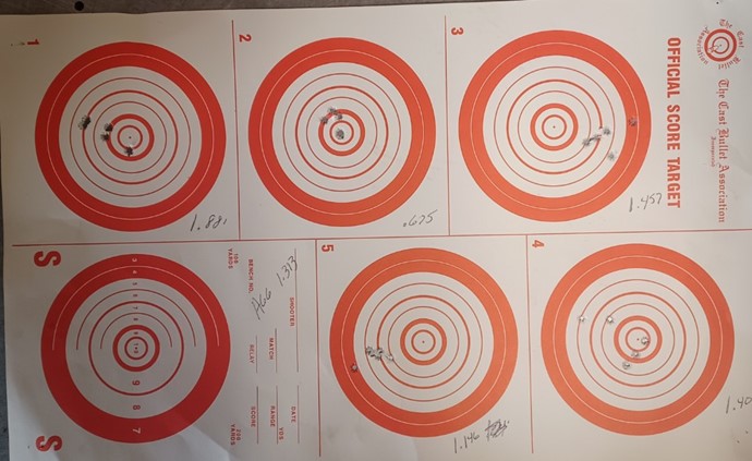

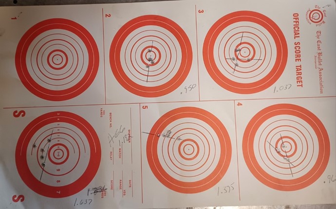

pat i posted this 26 March 2025
I went out today to do a little shooting. I wanted to try some coated bullets after shooting some lubed bullets. I have to say I'm not too disappointed. Maybe there's something to coating bullets afterall. I loaded and shot 125 greased bullets before these so was a little tired. No excuse mind you but I'm going to use it as one.
I stuck with #9 in Lapua cases with White River primers. I don't know the charge because I was able to boost the velocity up to 1350 with no leading, about a 60 fps increase over greased bullet. 1400 left a few flakes of lead but it came right out. I also ran a wet patch through every 20 rounds followed by 3 dry. I dont know if it helped or made things worse but it's what I did. I'm going to get some more bullets cast and coated and play with the load a little more to see if I can see any improvement but I have to say I'm pretty happy for the first go around.
Edit - The agg for the top target is 1.231
linoww posted this 26 March 2025
that looks pretty dam good! Much better than some of your earlier experience.
how did the other lubed bullets shoot?
Not as good.

John Alexander posted this 27 March 2025
Great groups Pat. The best I have seen since Dan Lynch's extensive shooting report on shooting PC plain based on the forum several years ago,
I f  I read the group sizes right and didn't screw up the math the average of the 11 groups was 1.14".  Wow for plain base in fixed ammo.  Were these from your 30-06?

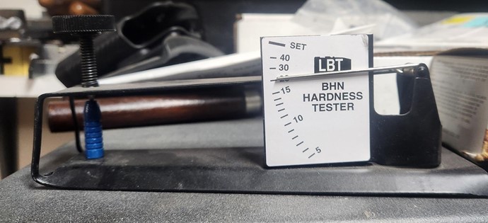

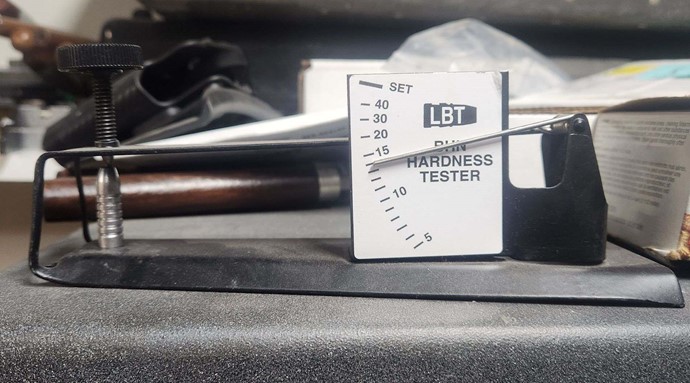

linoww posted this 28 March 2025
Here is non  quenched versus water quenched. The bullets are a little over 2 weeks old.The powder coat was quenched after taken out of the oven at 400° for 20 minutes by dumping in room temp water. The alloy is a large lot that I made up pure lead and monotype to roughly approximate wheel weights. Don't ask the exact ratios,I am not that detailed. It melted and cast a good bullet so I was happy with the alloy.
