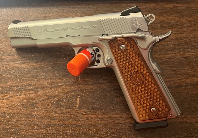

Has anyone besides me treated yourself to a Fathers Day shooting related gift? I bought a used 1911 today. I have never heard of Metro Arms until today. It's a gun made in the Philippines. Not a bad gun but it's really tight. Needs about 500 rounds through it.....for real......to settle the interfaces in. Barrel has NO THROAT whatsoever. I'll have to address that.

It's made in Manila by Metro Arms Corp. It is a bit rougher than the Rock Island guns but I bet they are from the same production lines. Would make sense. The retail price point is a tad bit lower than Rock Island guns too. Slide interfaces need polishing as does the barrel bushing. The used price was fantastic and the gun has barely been fired.
I bought it to fire the WW1 ammo I have on-hand. It's corrosive of course and I really don't want to put that through the Wilson. This gun I can dunk in a tub of water and soap to dissolve the corrosive salts. Then into a bath of Ballistol and water. Blow it off and presto - ready for the range again.
This gun should be a solid performer and will be fun to get smoothed out.

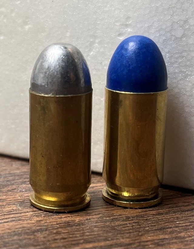

Rather than dither around with solutions to a problem that should not exist, let’s evaluate the known information.
The cartridge on the left with its cast 230gr Lee bullet in WW alloy, cast over 15 years ago, and now measures .453 just ahead of the case mouth, AND the cartridge on the right with a Blue Bullet at .452" loaded a few years ago, will fit effortlessly in a Wilson Cartridge Gauge, will chamber and extract easily in a Wilson CQB pistol, a Colt Series 70 pistol, and a Rock Island 1911 pistol. The problem is not with the cartridges, it rests squarely with the Metro Arms pistol and specifically, its barrel chamber.
 It seems as though the chamber reamer was either not run into the barrel deep enough or that the factory reamer was at the end of its service life, at its smallest allowable dimensions. Factory ammunition with jacketed bullets I have tried so far will chamber and extract fine, but no handloaded ammunition with home cast or commercial cast bullets (including powder coated bullets) will function in this barrel.
 This pistol needs either a chamber reamer or a new barrel. Simple as that. Having never performed a chamber reaming with a finishing reamer before, I have to ask if this is something I can do by hand or do I need a lathe or commercial type drill press to perform the reaming? I am guessing that it may be more cost effective to purchase a new barrel rather than try to ream it, ruin it, and then need to buy a new barrel to clean up my Dremel tool gunsmithing mess.
