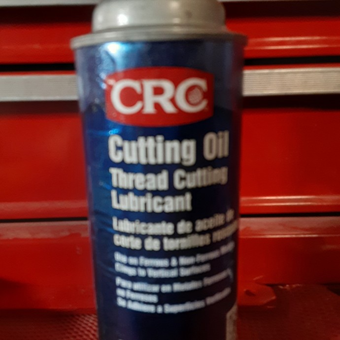

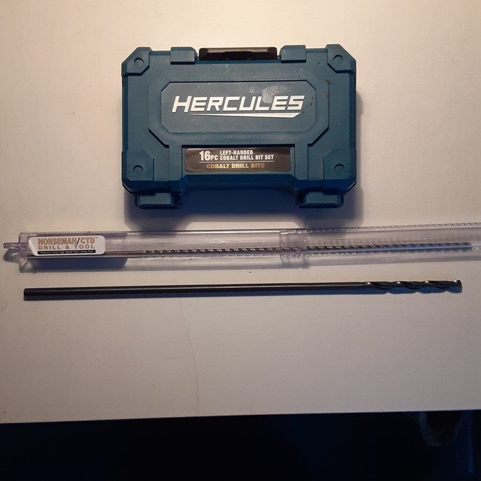

Holding the pistol by the barrel in a vice using wood and cloth for padding, I tried my standard high speed drill bits with no oil and a cut off .30 carbine shell case, (to protect the bore) on the one at the muzzle and got no where. Then on the advice from a machinist friend I tried cobalt drill bits and cutting oil. That drilled okay. I used left handed drill bits thinking it might "unscrew" the bullet down the rifling, which it didn't. I then used the screw on a slide hammer to pull 2 of the bullets out through the muzzle.

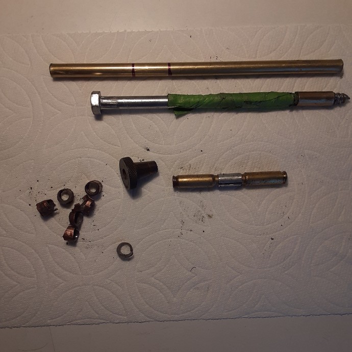

Then I used a 1/8" by 12" Norseman CTD  drill bit with 2,  5.7x28 shell casings with the primer pockets drilled out and a metal tube in between them for a guide to drill through the rest of the bullets. A .25" by 12" standard high speed drill bit would now bite into and drill successfully. I used the same metal tube and cut off .30 carbine case to protect the bore. By drilling into the bullets one at a time with the .25" bit, a lag screw with the carbine case and tape on, it could be screwed into the bullet. By grabbing the lag screw with a pair of vice grips and tapping on the vice grip jaws near the end with a small ball peen hammer, I was able to remove all but the last bullet. The last bullet was tapped out from muzzle to breach with a brass rod.
