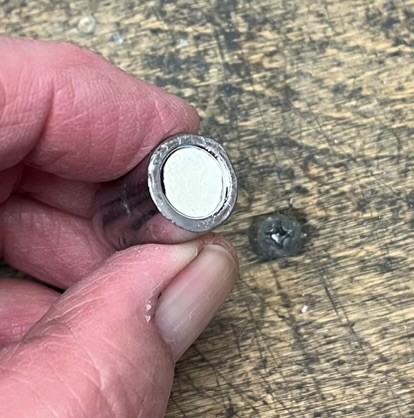

I finally got my clay plug mold clean enough to make the plugs which when made of clay, shrink to the correct dimensions to fit in both the N.O.E. .550" bullet mold, as well as the Old West Pritchett bullet mold.

I have tried his epoxy pea idea with multiple sources of epoxy. I simply can't get the plugs consistent or to reliably drop out of the molding bullet. I will continue to use regular clay formed in the N.O.E. plug mold and then fired for hardness. Works beautifully and makes consistent clay plugs.
Brett came up with the epoxy pea idea because N.O.E. hasn't made the plug mold for the .550 bullet for years now. While it may work for some, I cherish the pure reproduction of the cartridge in its final form with the clay plug. I appreciate your mentioning this in you post and bringing it to my attention. Do you also make these cartridges?

My clay plugs made with the N.O.E. plug mold

I just looked on the N.O.E. web site. The .550" bullet is no longer listed nor is the associated plug mold. They still list a .566" plug mold but no longer list a bullet mold there.
