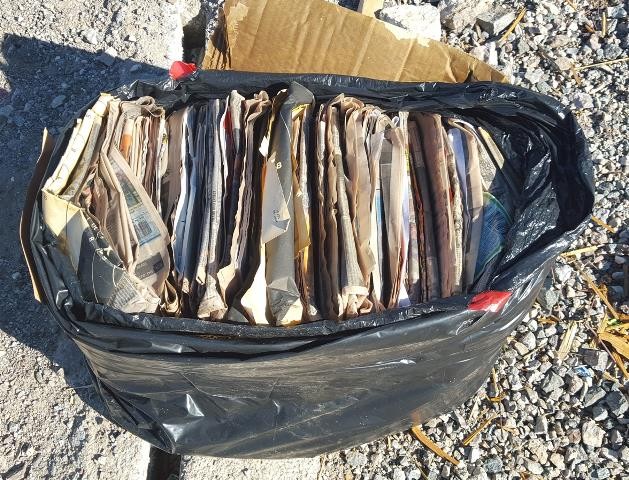

To “trap” the bullets with minimal damage I chose to use soggy wet newsprint. Previous tests with that medium proved it gave expansion to cast bullets.  Thus I collected a bundle of news print and used target about 18” in depth.  Those were placed in a plastic garbage bag (to retain the water), placed in a cardboard box and then thoroughly soaked for several days prior to the test.  At my local range (Sarah Park, Lake Havasu, Az) the newsprint bundle/box was palace at the 300 yard line.
At the firing line with solid cent benches I set up the rifle.  It was my 30x60 XCB barreled and chambered by goodsteel to the 30x60 XCB cartridge.  The barrel is a Broughton 31” Palma contoured stainless with 3 grooves with a measured bore of (Broughton) of .3077x.3003.  Goodsteel also measured it confirming those dimensions.  When I received the rifle I slugged the bore for groove diameter and came measured 3 different slugs at .3076.  I pin gauged the bore and a .300 pin would go in but a .301 would not.  The barrel was put on a CZ24 M98 action which I bedded into a Carlson Premier stock.  The rifle has a Leupold 6.5x20 target scope on it.
The test rifle;
Larry Gibson posted this 08 August 2019
The test load in the 30x60 rifle was the same 2900 fps load that I’ve posted about numerous times on this forum.  I have demonstrated numerous times and posted on this forum, including many pictures, the moa capability of the rifle, the cartridge and the cast 30 XCB bullet out to 600 yards.  Others have shot this rifle/load at 300 yards and attested to its ability on the CBF forum.   The bullet, as mentioned was the 30 XCB cast of #2 alloy, WQ’d, weight sorted, sized at .3105, GC’d with a Hornady GC and lubed with 2500+.  The 30x60 XCB cases were Winchester (formed from ’06 cases) with necks turned to fit the tight XCB chamber neck.  Primers were WLRs.  AA4350 was used with 53 gr giving 48-50,000 measured psi.  Muzzle velocity runs 2900 – 2910 fps.
The test;
An 8x11” target was placed on the front of the box of newsprint at 300 yards with a 1” paster in the center.  I shot 5 shots intending thinking the wind would spread the rounds out as it was a bit blustery so I did not quite succeed with that.  As it turned out the first 5 shots went into 2.19” at 300 yards.  I noticed one shot (#5) on impact blew out the side of the box and impact in the so I adjusted the scope up and right ¾ moa and shot a 6th shot to have 5 shots recoverable.  I should have shot a 7th as it was found that one bullet (of the two touching on the target; #4 & 3) hit the other bullet in the drive band area damaging it.  Had I not made that sight adjustment the 6th shot would still have been within the sub moa group at 300 yards.
The impact of the 6 bullets imparted considerable energy into the box/bundle.  The box burst and the bundle elongated to approximately 28”.
