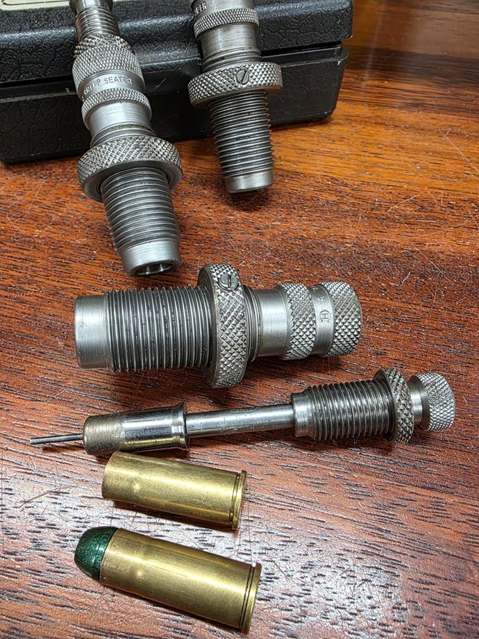

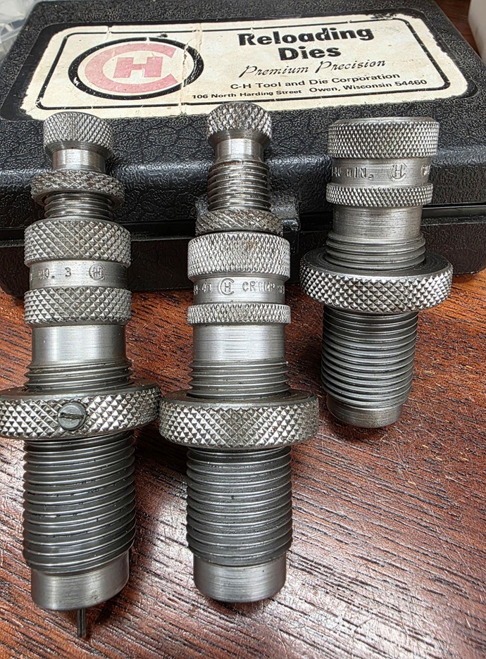

and here are some pics of the dies
C-H 44-40 die set
The Expander Decapping Die with plunger stem removed, a sized and expanded die and my first attempt at seating and crimping where the bullet could not quite get past the crimp ring which in fact seated it. The crimp effect was enough to close the case mouth up but not really a strong enough crimp. The bullet is the Spartan, a cast powder coated FP that mics at a tad under .431
