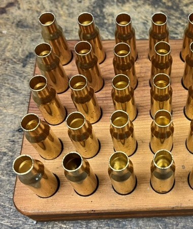

Having covered and set aside a loading block of primed 308 cases a few weeks ago, I decided to load them today to complete the loading process. I don't normally leave cases in this condition either on the loading bench or in plastic bags awaiting completion.Today when commencing work on these cases, I removed the paper towel covering them in the loading block and positioned the cases in an area prior to charging them with powder. At this point I noticed one of the cases was darker than the other 49 cases. You can clearly see the affected case below.

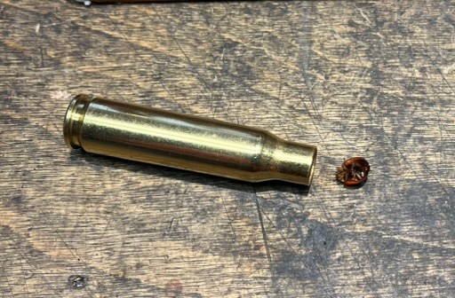

What in the world is that I questioned? Investigation revealed a desiccated Lady Bug lying in the bottom of the case. Not a spent or live primer, not another foreign object in the case - a Lady Bug.
I mention this since over the years I have read accounts of aberrant cartridges causing damage to firearms due to excessive pressure. Guesses as to the causative factors usually  settle on a double charge or excessive propellant charge in the case. I have long since wondered if something else may be the culprit like a biological cause nesting in the cases if left out on the loading bench. In my shed, the dang Lady Bugs are almost always present and they get everywhere! Those B-52 size flies are present and usually die on the bench behind the cleaning fluid. Wasps and bumble bees have also run me around the shed screaming like a little girl.
I did have a de-capped primer land in a case one time during the loading process so I know it's possible for other foreign material to find its way into a case and alter case volume. I would argue here that a case inspection before charging is always a good suggestion, as is looking into the cases after charging to identify any cases containing a larger charge of propellant. Bottom line here is that stuff, including biologic entities CAN get into your cases, even if covered. Darn bugs!
