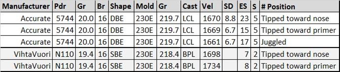

The data I had on powder tipped toward the nose vs the primer was even sketcher than I had remembered. No real surprise on that memory lapse. The only thing of value was the work I had done with 5744. On my "to do" list is to measure velocity, standard deviation and accuracy as independent variables and powder to nose, powder to primer comparison as dependent variables with additional dependent variables being a subset of the following powders; Unique, 2400, 5744, N110, I4227, Rel 7, 4198, Rel 10 and 4895. That pretty much covers the range of powders I play with with the 308 win and 200 - 220 grain bullets.
Here's what I have on the 5744. The N110 were only two shots each and they were probably left over reloads that sampled for Vel, ES just for the heck of it.

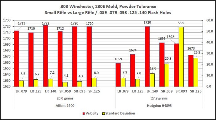

I believe powder sensitivity and how much emphasis is placed on how cartridges are handled from bench to chamber are related. I did a trial, and to paraphrase the process, I challenged the efficiency and consistency of powders by doing things like small primer vs large primer and small flashhole versus large flashhole. By the results you could see that some powders are affected more by change than others. Looking at 2400 and 4995 posted below you can see what I mean. Getting a half case of powder to burn evenly can be tricky regardless of their advertised burn rate. A powders grain size, its physical shape and properties makes a burn chart look kind of deceitful when it comes to half filled cases shooting cast bullets. Oh, and by the way throw in bullet weight, bullet design, bullet to bore fit and bullet to barrel fit with boreriders.
Using the greatest amount of caution I would think that positioning the powder towards the primer and not man handling the cartridge into a bolt gun may be the prudent way to go. My theory is that if results can be inconsistent and inefficient with manipulating things like primers and flash holes, the powder performance will be be affected by its position within the case.
