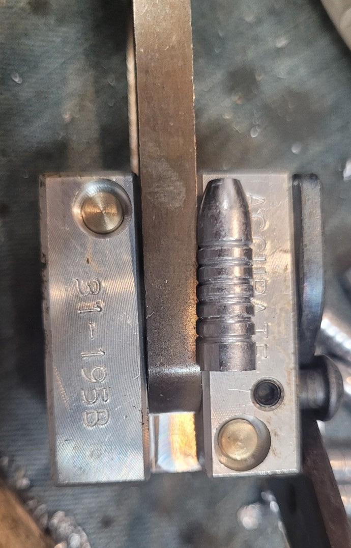

Got a new PB mold for my 06 fixed ammo project last week and took it out for the first time today.
The details are Winchester Mdl 670, Caliber 30/06, Accurate 195A bevel base sized .310, 13.5 grains of #9, Federal LR Magnum primers. Javalina lube in the grooves with a light coat of LLA cut 30%with mineral spirits over the top, clip on WWs for the alloy. Average velocity 1410 for the 6 groups, range 100 yards. Fairly decent wind for fall in Illinois

Thanks Ken. I don't know if I have the guts to go sans lube or do the greasy finger thing but I'll try different amounts and see where it leads me. I started this whole thing to show myself and others it's possible to shoot decent groups without the expense of checks, expensive alloys, and bigger powder charges but fast enough give you a halfway decent chance in the wind. Now for me at least it's morphed into wanting something cheap and easy that'll be competitive in the HNT class. Although throwing money at 5 custom molds looking for the magic one ain't exactly what I'd call cheap but maybe the next guy will get off easy. I buy molds like The 3 Bears. The first one was .970 long and weighed 167 grains. Shot alright at 100 but was off the paper at 200. The next one was 1.140 long and weighed 215 grains. It shot whatever at 100, that means not good, and was tipping like crazy. This one is 1.055 long and weighs 195 grains. And I won't mention the other 2 disasters. Hopefully this one does the job or by the time I'm done I'll have put Tom at Accurate Mold's kid through college.

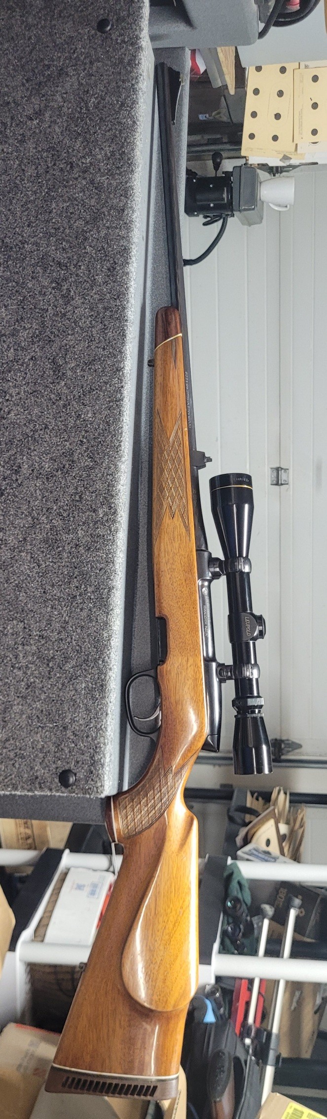

I'm going down the same path as Pat.Trying to get a competitive plainbase load for my 30-06 Steyr model M.

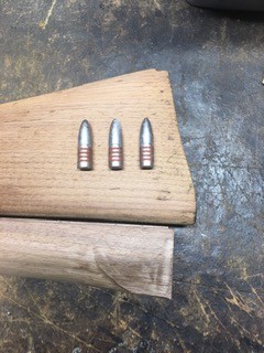

I’m in the process of sanding the butt stock of my Remington Rolling Block (1910?), to hopefully eventually match the new fore arm I just purchased from CPA. And then try to find a decent stain. Snooping on the forum, I ran across Pat’s adventures with a plain based bullet. I too use a plain based bullet but in a different rifle than his.
The discussion about quantity of lube got my attention. I never thought too much about the concept of reducing lube. So in preparation for match season 2024, I’ll be messing with reducing the lube in the bullet in the out-of-focus photo.
