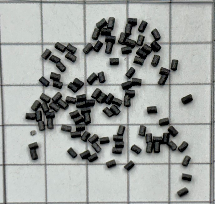

This is from my last 5744.  Dark gray/slate color and measures ~ .058 x .038.  Could anyone share dimensions & a picture of Buffalo R?

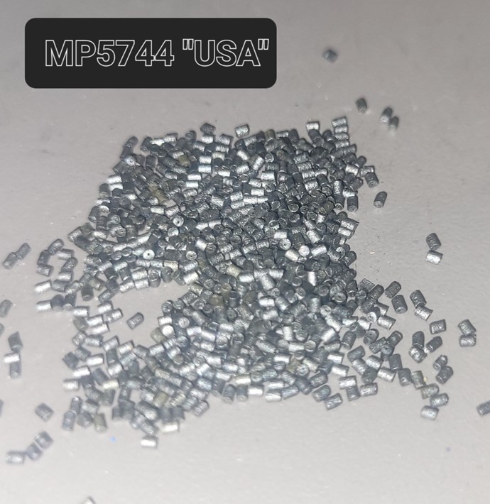

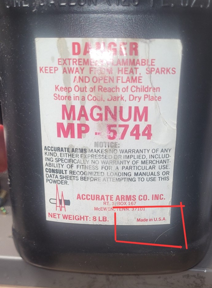

Looking into my powder stash I was excited to find an 8 pound jug of MP5744. This was the original surplus lot IIRC.Notice the holes in kernels.

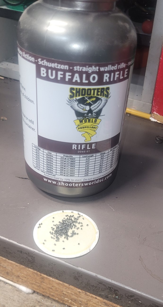

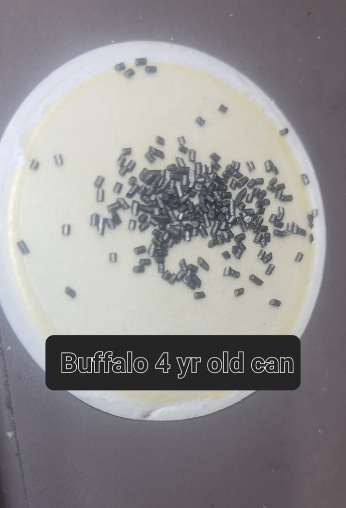

Also here is my Buffalo Rifle.

Hey George, thanks a lot for finding that jug of 5744 that I lost a few years back.  Off line we can discuss how you can get it back to me.  Just kidding.  From what I read the surplus had a nitro content of 10%.  Later variants had 20%.  I think the surplus powder dropped out of production in the early 80's.
Your 5744 looks like mine, more consistent in length than the 10 year old Buffalo Ric has or the 4 year old Buffalo you have.  Maybe its just lot to lot difference?  Who knows for sure.  I'll see if Shooters World will tell me what country their Buffalo Rifle comes from.  Thanks for the pictures.
