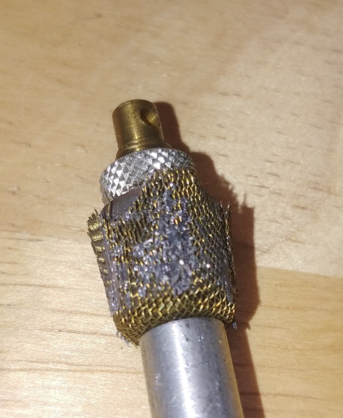

I'm just starting with pc'ing pistol bullets. So far, after limited testing on a Ransom Rest with a Browning Hi Power in 9MM, I'm not seeing anything to write home about.
 So far, I've shot loads with Universal powder from 3.3 thru 3.7 grains with a 126 gr. bullet at 11 BHN hardness.  Groups haven't been as good as with conventionally lubed bullets. Using my Quick Load Program and by comparing velocities of those predicted to those measured, the pc's bullet shoot slower than predicted. I intend to increase the charges up to 4.2 grs. in increments of .1 grain to see if things improve with hotter loads. That will be my next test.
So far, I've observed that the barrel had no leading at all but was fouled in the first inch and a half in front of the chamber with some unknown substance that came out easily with a few passes with the brass brush. The gun was very sooty around the chamber area and barrel that I don't normally see. This may be due to the cautious approach I made with powder charges that don't burn completely. I dunno.
Has anyone done an accuracy comparison of pc's bullets vs. regular lubed bullets in the same gun?  Did you get the same velocity?  Was the accuracy comparable?
My initial impression is that these pc'd bullets don't have the same bore friction as regular bullets. The fact that the don't go as fast indicates that they aren't developing the same chamber pressure due to less initial engraving forces and less friction going down the barrel.
If anyone has done any kind of a study on these lines it would be good info to share. If anyone is interested, I'll post the results of the next test taking this load up to a full case of powder (100 % load density)  to see what happens. Quick Load program predicts 4.2 grains of Universal to be a full case with 99+ % powder burn in a 4.8 inch barrel. Predicted peak chamber pressure is ~ 25,300 psi. which is way below the 35,000 psi limit for this cartridge.
This gun has shot groups under 2 inches at 25 yards with the same bullet conventionally lubed. So far, they've been 3 to 5 inch groups with pc'd bullets.
