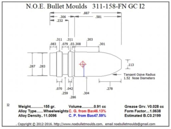

Is there a mold/alloy combination that would work in a 7.62 x 39 for whitetail/hogs? I can reach 1950 to 2050 with a few different powders using the 158 grain NOE 158-I2.
My restraints are that the magazine is limited to a COAL of 2.150 and the meplat has to be .115 or smaller. A flat nose greater than that (even .180) won’t feed/clear the rifle’s feed ramp. I’d appreciate your thoughts. Bill C

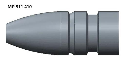

I've had very good results with MP's 311-410 HP with G/C. Alloy mix is 50/50 ww and lead
Wm Cook posted this 08 October 2025
Thanks Jeff. I don’t think that it’ll clear the feed ramp. I don’t have the dimensions of the nose but it looks like it’s ~ .200. I have his 314 (311)-140 SledgeHammer mold, HP and was initially counting on that, but it won’t clear the ramp. Thanks though, Bill C

With you shooting the MP 311-410 it looks like it comes with a 139g solid, a large 124g or a small 129g hollow point.  I'm curious about the velocities and the size of the meplat of the bullet.

I would think your meplat/velocity restrictions would call for a HP design.
The MP 311-410 has a similar (or slightly smaller) meplat than the NOE 322-158. The pin for "large HP" is really deep (through the nose, and halfway down the front driving band), best reserved for varmints. The "small HP" might work, for a diciplined hunter avoiding the most difficult angles.
The HP nose i quite fragile, though; I don't know how they will handle cycling through a semi-auto.

Thanks. It’s good news about the nose size on the MP 311-158, and you’re right about the potential nose damage while feeding. I hadn’t considered that.
From what little I’ve shot the Ruger Ranch, NOE shot groups about half the size of the MP groups (2" vs 4"). Here in Missouri, 2 MOA is all the accuracy I’d need.
My concern is that without a softer alloy and or a hollow point design, there’s the likelihood of a through and through shot with no expansion. Without hitting bone, my unfounded guess is that #2 alloy without a larger flat nose, would make a .311” exit hole.
With the .113 metplat on the NOE would it be possible to modify it to be a hollow point? Availability from MP is iffy over tariffs. Bill C.

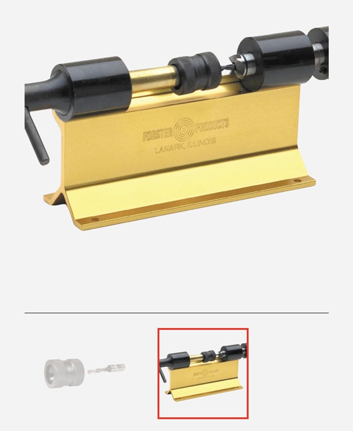

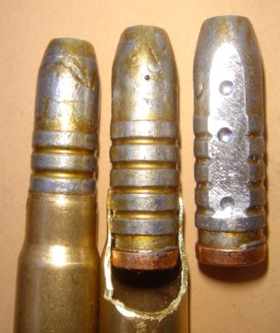

Another option might be to drill a HP on the relatively few bullets you need for hunting;
  • drill press and some sort of jig?
  • lathe-type case trimmer, modified .32 case for "bullet holder", and replace trim guide with drill bit?
  • I believe Forster might offer a "HP kit" for converting their case trimmer to HP maker.
Just throwing around some ideas.
  • mashburn
Wm Cook posted this 09 October 2025
Thanks for that.  I didn't know about the Forester kit and I even have one of their trimmer packages kits.  Giving it a try it would proof whether it centers consistently enough to hold some semblance of accuracy.  Al still has some of the NOE molds still available.  I wonder if anyone could manufacture an after market pin for one of his remaining two cavity molds that's available.  Bill C.

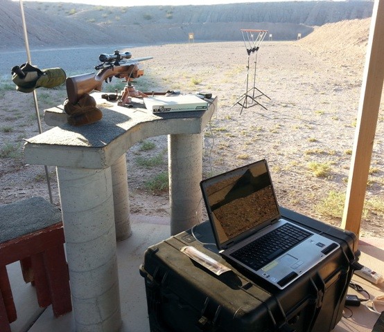

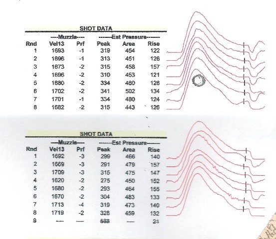

Here's a post I made several years back over on the "boolits" forum.  You may find some useful information in it appropriate to the topic of this thread.
Junior1942’s 7.62x39 loads
During the latest thread on LeveRevolution Powder Junior1942 PM’d me asking about the 30-30 testing I had done with the RCBS 30-180-FN and that powder.  He asked about the test and was trying to correlate the psi’s from that test to the 7.62x39 for possible use in his Yugo SKS.  He primarily was interested to see if the LeveRevolution powder would give him a bit better performance under his COWW cast bullets which weight 197 gr.  I suggested there was no sense trying to correlate when I could pressure test in the 7.62x39 also.  I suggested he send some bullets and the data for his other powder loads and I would pressure test those also.  Junior thought that was a great idea.  He asked how many bullets?  I told him a hundred minimum.
Junior scrounged around and found about a hundred (104 to be exact) he had already cast and said he’d cast up some more and send ’em if need be.  He said a few were wrinkled.  Told him they’d be fine for the initial LeveRevolution work up as we were interested there was the psi. I got the bullets a couple days later.  They were sized at .314, had Hornady GCs and were lubed with LLA.  The BHN measured 11 – 12.  I proceeded to check out the Mini Mk X Mauser I would use for the test.  Unfortunately, the strain gauge had partially cracked for some reason.  It hadn’t been used in over 2 years and the change in location, temperatures and humidity are my guess why.  Called the company to order some more gauges and they would take about 6 – 7 weeks.  Told Junior and he was a bit down over that.  However, in about 2 weeks a package showed up with the strain gauges.
I PM’d Junior and told him I was ready to test and asked a couple clarification questions about his standard loads.  I didn’t hear back from Junior and just assumed he was away or busy.  I did not know he had gone to the big range.  I proceeded with the test and will post the results here…..for Junior…..rest in peace, may the sun always be to your back, the wind in your face and all your shots go true.
Test rifle; Interarms Mini Mk X
Caliber; 7.63x39
Bore; .301
Groove; .311
Barrel length/twist; 20”/1-9.5”
Sights; Bushnell 4X scope
Test equipment; Oehler M43 PBL
Range; Sara Park, Lake Havasu City, AZ
Test range; 100 yards, solid cement benches
Rest; Hoppe’s front and leather sand bag (rabbit ear) rear
Test shots; due to limited number of bullets not all test strings had 10 shots.  Some had less but not less than 7 shots.  The LeveRevolution psi workup had 2 shots per powder charge.
 The test was conducted on two separate days early in the mornings.  This gave the least heat (this is the desert with daytime temps running 105 – 115) at daybreak (85 – 90) and the least wind.  Juniors’ standard loads and the LeveRevolution psi work up was conducted on the 1st day along with a LeveRevolution psi workup with a 175 gr C314041 cast bullet of my own.  The second day was the test of 3 loads of the LeveRevolution under Juniors 30-180-FNs and 3 loads under my own C314041.

 Junior’s chronographed velocities were about 80 fps less than the ones I recorded.  The velocities I list are corrected to the muzzle and different rifles were used of different actions.  Additionally, the lot to lot variation of the powder used and I was testing in 85 – 90+ degree temps all combine for the differences.  For what Junior was looking for (a “smack down” hog load for 100 yards or less) his Varget or 4895 loads would have been fine.

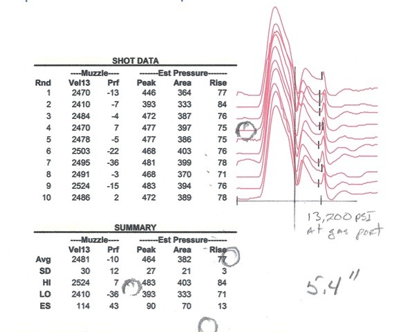

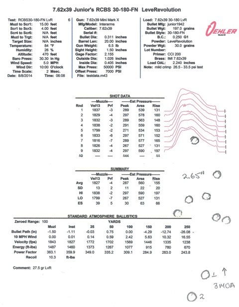

 LeveRevolution Powder with the 30-180-FN at 197 gr in the 7.62x39
 I did a “workup test” using LeveRevolution powder. What I do is usually load 2 cartridges (sometimes just one) of increments from a start to a projected “max” load.  I used to call this “ladder testing for velocity and psi” but too many confused this with the “ladder test” commonly used for working up loads.  What I do in this initial psi/velocity testing does not consider accuracy at all.  My testing is concerned with velocity and psi.
With LeveRevolution powder I worked up from 23.5 gr to 28.5 gr in 1 gr increments.  28.5 gr was at 105% load density with the RCBS bullet.  Velocities ran from 1554 fps to 1924 fps with psi’s from 20,100 to 36,300.  Knowing the RPM threshold was between 1700 fps and 1750 fps with the other powders I loaded 25, 26.5 and 27.5 gr looking for velocities from the mid 1600s to the mid 1800 fps.  The idea was to see how far the much slower burning LeveRevolution with its radically different time/pressure curve would push up the RPM Threshold.
25 gr;
Velocity; 1668 fps
Psi(M43); 22,400
Accuracy; 6” (7 shots)  and very poor.  There was soot blown back the expansion ring on the cases indicating poor breech sealing.
 26.5 gr;
Velocity; 1771 fps
Psi(M43); 26,500
Accuracy; 2.4” (9 shots) no soot on cases.  Accuracy definitely improved.
27.5 gr;
Velocity; 1843 fps
Psi(M43); 28,700
Accuracy; 2.65” (9 shots) definitely pushed the RPM Threshold up as RPM is 139,700.  28.7 gr is worth a try but alas I am out of the RCBS 30-180-FN bullets………note on the target the 1st and 2nd shots were right at the bottom of the target I was using.  To make sure I didn’t lose any shots off target I moved the scope elevation up 3 moa.  Those 1st two shots would have been in the group.
This definitely should be the better “smack down” load in the SKS that Junior wanted.  Graphing out the psi at the gas port shows a projected 8000 psi which is less than with the different Russian made factory 7.62x39 ammunition.  I would have tested this load in my own SKS but again, I am out of the bullets!  Perhaps Junior is hunting with this load already!  I sure hope so……and I’m sure he wouldn’t mind me sharing with all of you.  That’s the kind of guy Junior was.  He loved to share here and on his own web site.  I will miss Junior……….

In a Ruger 77MKII, I used the Lyman #314299 design that had been professionally hollow pointed by Eric Ohlen. Bullet weight was about 200 grains, 13-14 BHN. I used H4895 powder that provided a MV of about 1750 fps. Never hunted hogs or deer with this load, but if I did, I would cast the bullets a bit softer for expansion.

Since you are satisfied with the accuracy of the NOE 311-158-FN, it's meplat is only .113" and I highly doubt it could be effectively hollow pointed without making the meplat wider, maybe try this,
  • Obtain something pure lead of the required size to fill a portion of the nose of the mold to the desired amount but not touch the barrel. Could be 000 buckshot, split shot, etc. I purchased a Lee 000 mold.
  • Have your bullet mold heated to casting temp. on a hotplate or other means.
  • Have your normal rifle alloy at casting temp in the pot/furnace.
  • Melt the number of 000, split shot or whatever you decide to use per bullet in the ladle with a propane torch.
  • Pour the pure lead in the mold and immediately finish filling the mold with your rifle alloy.
  • Now you have a bullet with a soft nose and a harder body that will not lead your barrel quickly.
With practice, you will hardly get a noticeable seam in the bullet, mostly just a color change between alloys.
Wayne
delmarskid posted this 12 October 2025
At one time I cut strips of paper about a quarter inch wide and lay them across the nose of my hot mold behind the meplat. I closed the mold carefully and cast my bullets as I normally do. This strip did make the nose a bit larger but with a 7.76x39 this may work out well.
