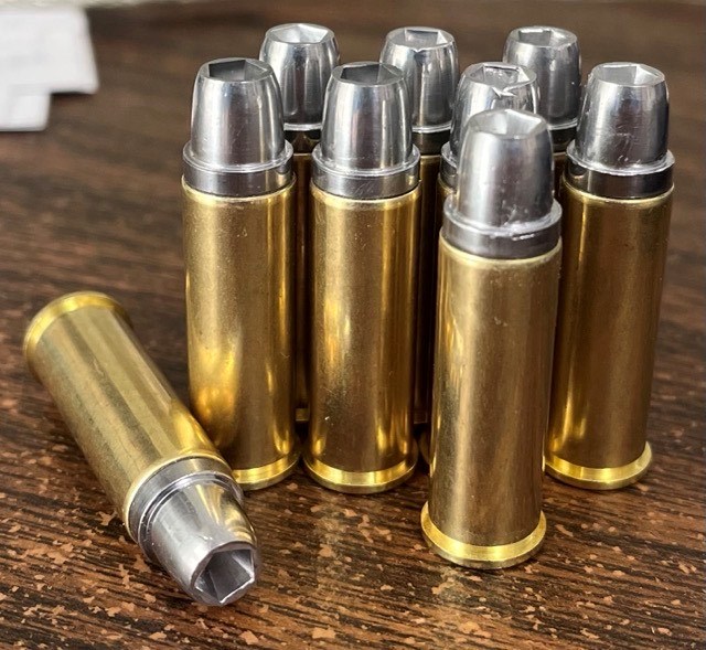

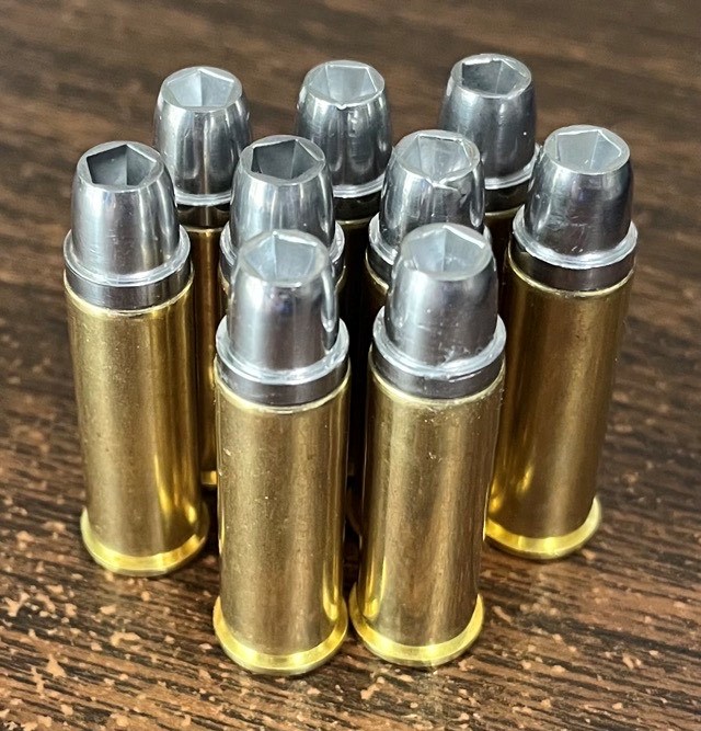

Finally loaded up some of these MP mold 41 caliber bullets. They are cast in Lyman #2 alloy and drop from the mold at .4145" which is a tad on the large size. I ordered a custom .411" sizing die since Lyman, Lee, and RCBS offer nothing but a .410 die. Sized these up and lubed them with White's 50/50 lube and shoved them out of the tube with 16.0gr of Heavy Pistol powder.
Brother these are warm. The Ruger NMBH beat me up. I didn't wear any gloves to test the loads. I will need to get these over the chronograph at the first opportunity.
Mold casts nice bullets!

Does that penta hp release easy from the bullet?
Aaron posted this 09 May 2025
Surprisingly,,,,yes it does. Mold and alloy temperature are important however.
