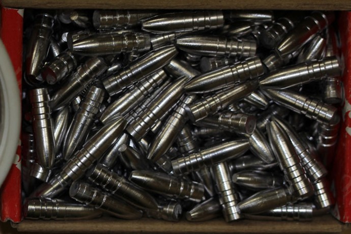

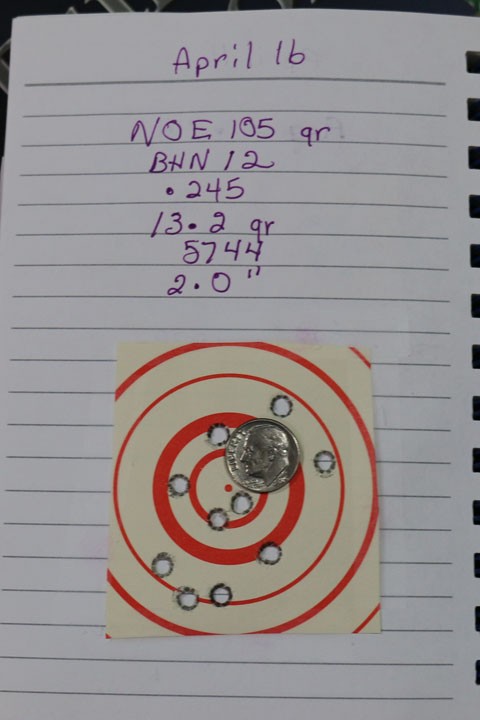

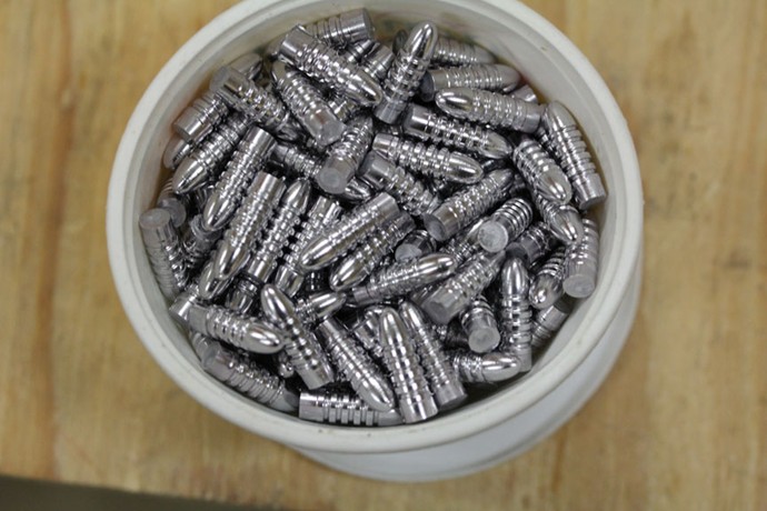

This past month a number of us have been playing with plain base bullets in largely 30 caliber rifles. It was surprising to me how readily we have found pretty good loads using softer alloys and lower velocities. I decided to try the same thing with the 243. My bullet choice is the NOE 105 gr. The alloy is the same alloy I have been using for PB bullets in my 3006. Finally I took a couple of accuracy loads from the older Lyman manuals.

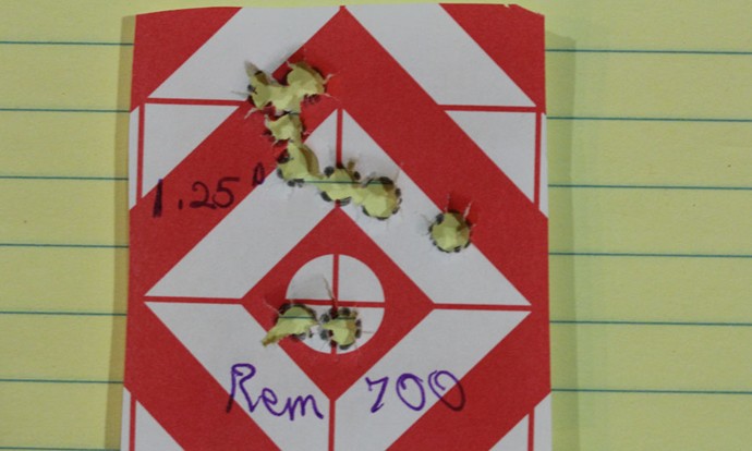

I should mention that I was shooting in a 15 mph gusty wind. So then here is the first group using soft slow fat bullets:
  • 2frogs
Scearcy posted this 17 April 2017

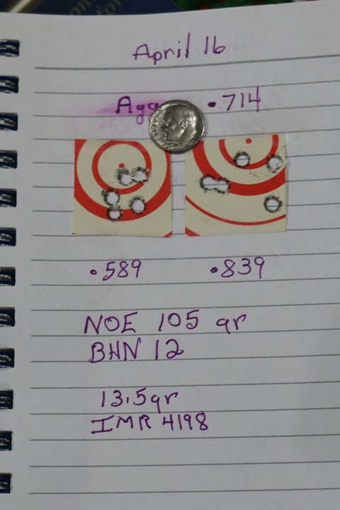

The first group looks like a number I have shot in the past. I think this load would benefit from an additional 1/2 gr of powder.
The next 2 groups are a revelation to me. I only shot them 2 hours ago so in my methodical (slooowwww) way I need to think about this a bit. I thought you guys would find these groups interesting. They are within spitting distance of the National records in Hunter class. Who would have thunk?
  • 2frogs
OK I am not really arguing here but rather thinking out loud. First if I can continue to get anything close to the two groups above, it is going to be hard to get me to try another alloy. Second I have 3 pots sitting on my casting bench. One contains pure lino, one contains foundry 92-6-2 and one contains a secret mix (just kidding) that measures exactly BHN 11.5. For the last three months I have shot either pure lino or pure hardball (92-6-2) in these 243s. These are BHN 20-22 and BHN 16-18 respectively. I have shot them slow and I have shot them fast. I have been rewarded with an occasional 1.25” group and have shot a bunch of 1.5” - 2.0” groups.
There is no magic here but rather well over 800 rounds through 3 rifles using two foundry pure hard alloys and at least a half dozen powders. According to my notes the best groups have usually been in the 1700 fps range using loads which are closer to minimum that maximum. The Lyman manual I have been following notes that best accuracy with the 243 is usually obtained below 1750 fps. That has been my experience also.
I have retired the two faster twist rifles to so they can pursue other interests. Since the slower twist barrel was the most accurate, I decided why not try it with a softer alloy ahead of a slightly gentler load. Why not indeed? If I can get a 7 1/2# sporter to shoot a 9/16” group in a 15 mph wind and then follow it with another sub 1” group, the load will have my undivided attention.
I have been shooting registered CBA matches for over 20 years. I know that conventional wisdom is that small bore gas checked bullets need to be hard. I have measured some really good groups which were shot using linotype bullets. We compete comfortably in the knowledge that when in doubt, try a harder bullet.
Maybe so, maybe not so. I usually like to believe what my eyes tell me and I have seen very few groups shot with conventional equipment that are any better than that one above. Does one group prove anything? Not much except maybe when it is a tight as the .57 group. Do 2 groups prove anything? Prove - no. Indicate - probably.I believe these are the best 2 groups I have gotten since starting this project. You can be sure I will shoot several more groups before relying heavily on this load but I am unlikely to abandon it before it has been thoroughly tested. I do remain aware of the fact that the warmer weather may be contributing to better performance now. It is also true that I have solved the lube problems I was experiencing early on. Both of these facts could be giving this load an edge relative to the harder alloys I was shooting in February.
Anyhow this is getting too long. I apologize for sounding irritated but I was. If someone would like to join me in this effort, feel free to say so. PM if you wish. Now that spring is here I will be unable to continue to commit this much time to testing loads.

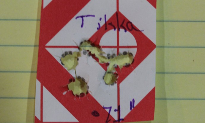

Scearcy posted this 02 May 2017
I promised to get back to this thread once I had an opportunity to shoot some more groups. The picture is fairly much self explanatory. I ruined the one group by going into brain fart mode and changing my grip for 3 shots. Old habits die hard, particularly bad habits it seems.
I am going to shoot this load in the local matches this summer. It will be interesting to see if it holds up at 200 yd.

frnkeore posted this 03 May 2017
Excellent, Jim! I like it!!!
I'm suprized that 4198 can produce such great accuracy at those low pressures.

John Alexander posted this 03 May 2017
Terrific string of groups!  I have lost track of which rifle you are now shooting. Whatever it is it may turn into a pretty good rifle when you get it tuned up and start using hard alloy.
Historical note:  The late Mike Mohler was shooting 4198 in his Ruger 243 when he won all the marbles at the 2007 CBA nationals and set a batch of records three of which are still standing, in spite of nine additional years of good shooting by other production class shooters, almost all shooting 30 calibers as God intended.  Mike was using 17.5 grains with a 95 grain Mos bullet.
Scearcy posted this 03 May 2017
The Tikka of course.
Hard alloys and 30 calibers as God intended - You've left me with a smile!
