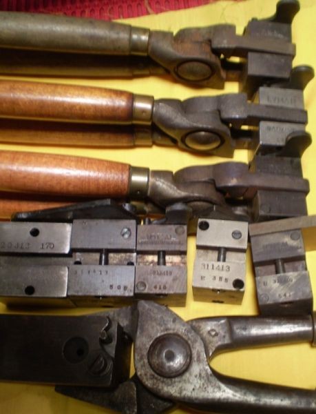

<user=1379>Reg Lingle wrote: Wow! Resurrection of the Lyman 311413. Don't think I need one! Reg The 311413 is a addiction, all by itself. Top to bottom
11413 EX S .306, 311413 U EX .308, 311413 S .309, 311413 U .310, One of these isn't pictured I reamed a .310 PB on it. 311413 .311, The rest run from .313 - .314. All the above cast in 20/1. One of these aren't pictured, I reamed a .315 PB on a .313 mold for my German Schuetzen rifle. There is also one H&G and one B&M pictured. I don't have them all, I still need a Modern Bond and a Herters
Frank, You are also missing the Yankee brass mold for the 311413. I had one but sold it. Bras mold cast easy but bullets did not shoot any better than the Lyman.
I've messed around with the 413 oven heat treated. It shoots just fine.
