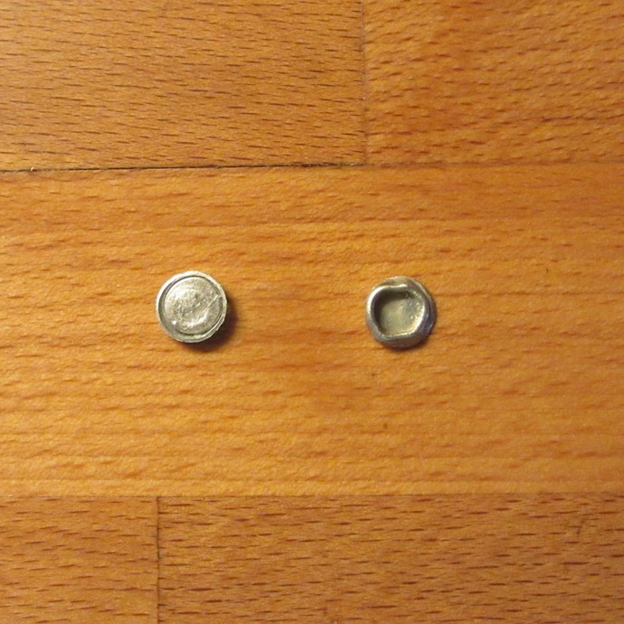

I've fired a couple hundred of these left handed gas check loads. I've found two of the checks on the ground total. I've dug or rather examined my berm for bullets and picked up a few. I found no checks on any of the bullets nor have I seen evidence of the checks ever being attached to the bullets. The checks that I picked up are flattened and have a print of the sprues stamped into them. I took pictures but I can't post because the pics use too many bits.
It appears the outside standing edge was supported by the bullet and the unsupported center collapsed?
Hi Ric, I'm pretty sure that is what is happening. The flat of the check gets blown up against the base like a paper cup hit with a hammer. I cleaned after 125 rounds shot one after the other in an hour or so and got no leading. I don't know if store bought gilding metal checks will act the same. I will drop or place one in a case and see how they fit before I try them. My aluminum checks are large enough to need a little pressure to fit the mouth of the case.
