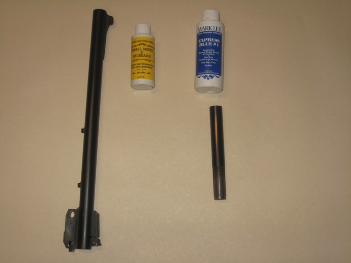

Just to clarify the photo a bit. That TC Contender barrel on the left was polished with 320 grit paper and then blued with Laurel Mountain Forge browning solution. 400 grit was used on the other barrel before using Mark Lee's #1 rust blue.
The intent was to try to show the difference between the two. Contender barrel more of a flat finish as compared to the other which is more glossy.
