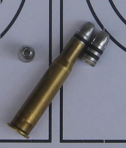

This is #311576HP, seated to engage the throat.

The Lee 110 gn soup can is another bullet I have used in this application.
