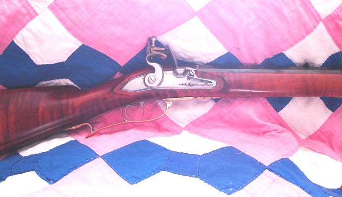

I spent five great years building this French and Indian War flintlock in my spare time. The lock alone took a year. Only used hand tools, no power or modern stuff. Shoots 54 (.530") WW balls with thin patches. It will stay inside a deer target at 50 yards all day long. Someday I will cast up some pure lead balls and try traditional patching.

Looks like you did a great job, Ric!

Very nice!
rhbrink posted this 03 March 2017

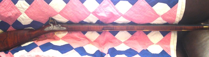

Nice rifle do you happen to have a full picture of it? Bet that you will find that soft lead shoots much better and to use anything but Holy Black the Mother of all powders would be sacrilege in my humble opinion. All the rest of that fluffy fertilizer stuff is just a passing fancy.

RicinYakima posted this 03 March 2017
Richard, As you requested, attached is a picture. I shoot and load this just like they did in 1748, except I use scrap WW's rather than pure lead. Just haven't gotten around to it yet. Shoot 3F in the pan and barrel and only had one fail to fire when I forgot to wipe the storage lard off the frizzen for the first shot.
Fine looking rifle you do good work bet that lard would retard the spark all right probably make it non existent.
David Reiss posted this 06 March 2017
Ric,
Very nice, even more so knowing that you did it all with hand tools. Give me a photo taken outside that I can post in the gallery.
